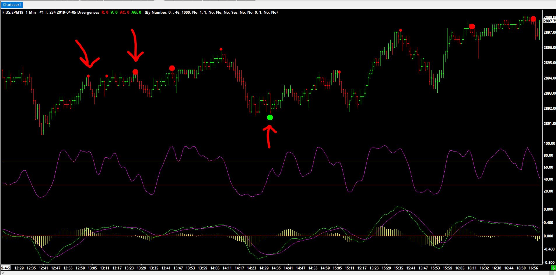

I know some Sierra Chart customers appreciate a decent (not perfect) divergence detector.
Not sure if this is a good way to share what I created, but here it is.
In a nut shell,
both MACD (large dots) and Stoch Slow (small dots)
1st and 2nd peak and null identified, MACD and Stoch Slow
1st MACD and Slow Stoch peak or null, Peak or Null current price captured
2nd MACD and Slow Stoch peak or null, recent Peak or Null current price captured and compared to 1st
Yes, this study set is a bit upside down, in that price is not the primary peak/null, but MACD and Stoch Slow peak/null is the trigger
And when there is divergence found a green dot will be for 'long'under the price candle and red dot will be for 'short' below the price candle
I set MACD divergence as a larger size #10 dot
I set Stoch Slow divergence as a smaller size #5 dot
If you copy this study to your C:\SierraChart\Data drive I should work
If not let everyone know in the replies
Mark

[2019-04-07 22:14:01]
User743797 - Posts: 1
thanks for the study, i added to my data under Sierra but i can't get it to come up
[2019-04-07 23:49:27]
User7817001 - Posts: 96
Sorry, you may also require the 'blank.scss' file which is referred to within the divergence study within the collection, it's attached and should also go into the data directory
Also, any studies you add in addition to this collection need to go after (bottom) of the three within the collection, or the added studies will break this one.

[2020-02-14 13:40:50]
mtomas - Posts: 21
hi mark
i downloaded the collection, and am using it, i do see the blank.scss in my SC, but i do not get any signals on my chart.
its the eh20, emini current contract, ive tried on 1 min, 5 min, 30 min, everything seems to load but no signals
anything i should tweak? thanks for the help

Did you get it working? I finally got it and hooked it into another spreadsheet file, but in translating the cell IDs I noticed an error in MACD T/B referencing X2 and X3, which I'm guessing should be X3 and X4. Is that right User7817001?
[2020-05-22 10:22:37]
I presume you are referring to the formula in cell Y3 only, this cell will never trigger an "Top" or "Bottom" for the very reason you have seen, if you examine all other cells below Y3...Y4,5,6.. you will see the formula compares the two cells in column X, which DOES post a "Top" or "Bottom" from row 4 and down...while your observation is true, the outcome does not result in an error, thanks for looking through it

Thanks.....yup I tried both under Data directory and same result as per the last 3 tries. Not available either on Add Custom Study nor Studies Available. What is the name it is supposed to be on either study?

I got both the files in my data folder - Blank.scss SpreadSheet and also opened it.
Then in Analysis I found EMCWIZ Divergence MACD and Slow Stoch.StdyCollct , but not able to get it added to my Studies.
Please help me on the procedure. Or is it that files are from 2019 and so not working for me?

sorry for the question, I never used a study whith a scss file. Do I have to load the scss file as a study or only copy the both files into the Data directory and open only the .StdyCollct file (in SC menue "Analysis")?
I'm asking because nothing happens when selecting the .StdyCollct file, it seems it can't be loaded ("Studies to Graph" window is empty) - or maybe the files really don't work with newer versions of SC?
Thanks for infos
Kind regards
Tom
[2023-02-27 16:55:15]
Sawtooth - Posts: 4361
Do I have to load the scss file as a study or only copy the both files into the Data directory and open only the .StdyCollct file (in SC menu "Analysis")?
Put both files in your Sierra Chart \Data folder, then go to Analysis and click on the study collection.
...maybe the files really don't work with newer versions of SC
Older chartbooks and study collections need to be converted to work in newer versions of Sierra Chart.
Chartbooks (Workspaces): Opening Older Chartbooks
[2023-02-27 17:52:11]
User123091 - Posts: 6
nice, thank you very much for the info - now it works ;-)
