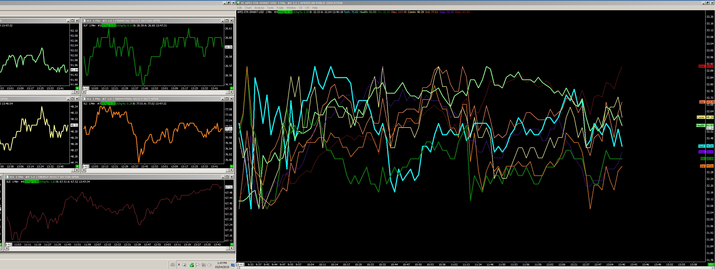

I have a graph with 8 Overlay (Single line) that sometimes is delayed or stops working and I've got to hit "Delete and Download data".

Do you see the data in the source charts? Is there a problem with the source chart updating?
Go to the source chart and provide an image of that.
Provide an image of the chart or Trade DOM, by following these instructions:

lpfin123 - Posts: 59
See attached screenshot
In this case, the red line "source chart" price is 67.52, and in the study 67.54.
imageScreenshot.JPG / V - Attached On 2019-04-05 17:52:40 UTC - Size: 1.2 MB - 417 views
[2019-04-05 18:01:02]
We need our questions answered as we have requested.
Provide an image of one of the source charts that is not updating following the instructions here only:
And let us know if it is not updating.

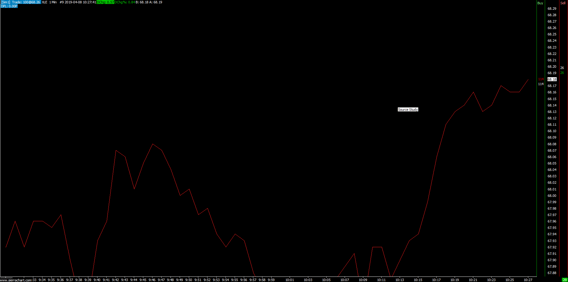

[2019-04-08 14:28:38]
There doesn't seem to be any problem with the source chart. It is consistently updating.
http://www.sierrachart.com/image.php?Image=1554733661464.png
