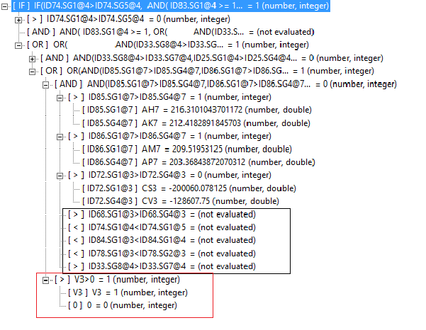

I'm having trouble with the lock variable function not triggering fully accurately at times..
I might have an AND() clause where it contains "@4 to @4"/"@4 to @5" along with my "@3" stipulation(s), but the @4's and @5's seem to not always evaluate in the clause(under spreadsheets' logic details) for some reason...
So for example:
OR( AND(ID74.SG1@4<ID74.SG1@5, ID84.SG1@3<ID84.SG1@4, ID78.SG1@3<ID78.SG2@3, ID33.SG8@4>ID33.SG7@4) ,V3>0)
^^ I would have something like the above, and once an "@3" attribute within the AND() clause triggers, the rest seems to not evaluate(according to the details window) where I in fact want it to obviously
In the details window screen, I see the "V3"(or equivalent when looking back down the cell column) with a "1"/TRUE value in it, meaning that it skipped the rest of the clause and is now fixed as TRUE(?)
I'm just a bit confused here tbh..
imageresult.png / V - Attached On 2019-04-05 14:06:23 UTC - Size: 31.76 KB - 437 views

I guess what I'm wondering now, is why the V3(highlighted in the red box in the picture) would now equal 1 where the rest of the clause hasn't even been made true yet...

but for example, in the code corresponding to the detail analysis image:
OR( AND(ID33.SG8@4>ID33.SG7@4,ID25.SG1@4>ID25.SG4@4,ID68.SG1@4>ID68.SG4@4,ID51.SG1@4>ID51.SG4@4,ID51.SG1@5>ID51.SG4@5,ID51.SG1@6>ID51.SG4@6,ID72.SG1@4>ID72.SG4@4,ID74.SG1@4<ID74.SG1@5,ID84.SG1@4<ID84.SG1@5),OR( AND(ID85.SG1@7>ID85.SG4@7,ID86.SG1@7>ID86.SG4@7,ID33.SG8@4>ID33.SG7@4,ID72.SG1@3>ID72.SG4@3,ID68.SG1@3>ID68.SG4@3,ID74.SG1@4<ID74.SG1@5,ID84.SG1@3<ID84.SG1@4,ID78.SG1@3<ID78.SG2@3) ,V3>0) )
In my case above, it seems that when the first and second "AND()" clauses went false, V3 still came up with a TRUE reading somehow(?)
I don't see where/why V3 became true tbh.. Is it possible that the spreadsheet program is carrying over the "previous V3's" TRUE via some strange delay?

No, the issue remains
I just actually tried removing the OR lock clause around the "AND()" clause, and as expected, V3 stays false..
And again for some reason, upon adding the lock back, V3 finds itself as TRUE again...
^^This is essentially the formula section thats acting up.. and by lock clause, I was refering to the lock in the code formation from above: "OR( AND(), OR( AND(),V3>0) )" to basically lock the whole secondary condition if it becomes TRUE.
In the main formula, I put the "ID74.SG1@4<ID74.SG1@5" of the second "AND()" in bold to just to highlight that this condition is NOT met in the image example(nor is the first), and therefore the rest of the statement should NEVER ring true
Again, its strange because from the image I sent, the spreadsheet asserts correctly that neither AND() is true - So the V3 being TRUE(in the red box of picture) confuses me...
