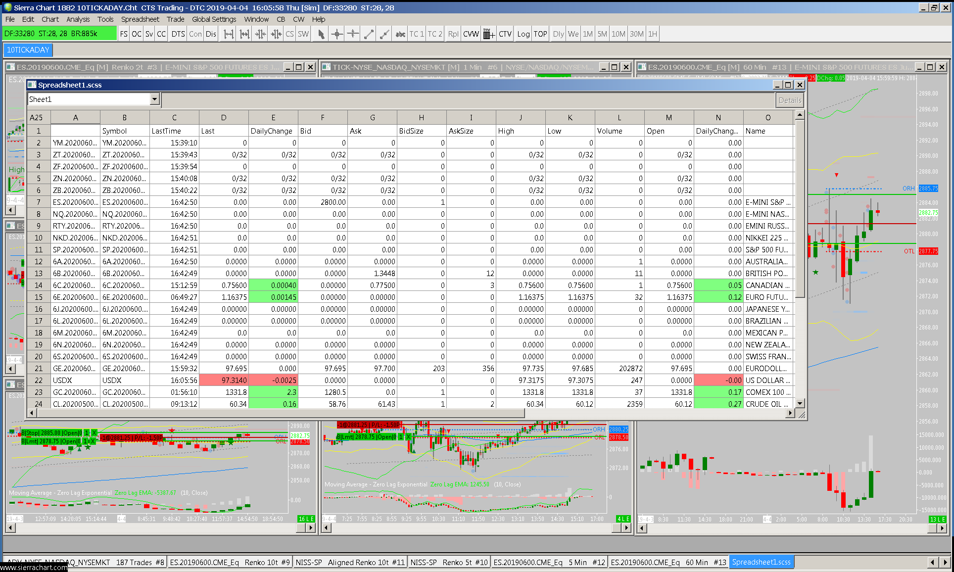

I've attached an image of a quote-board spreadsheet that I've added symbols too. I'm only getting data for 5-6 row's. I have 24 rows with symbol's. Bonds, etc.. All symbols are from CME. Can you help? Thank You

Increase the number of symbols here to 100:
https://www.sierrachart.com/UserControlPanel.php?page=ExchangeDataFeedFeatures#DataConnections

OK Thank You for the quick response!!!
