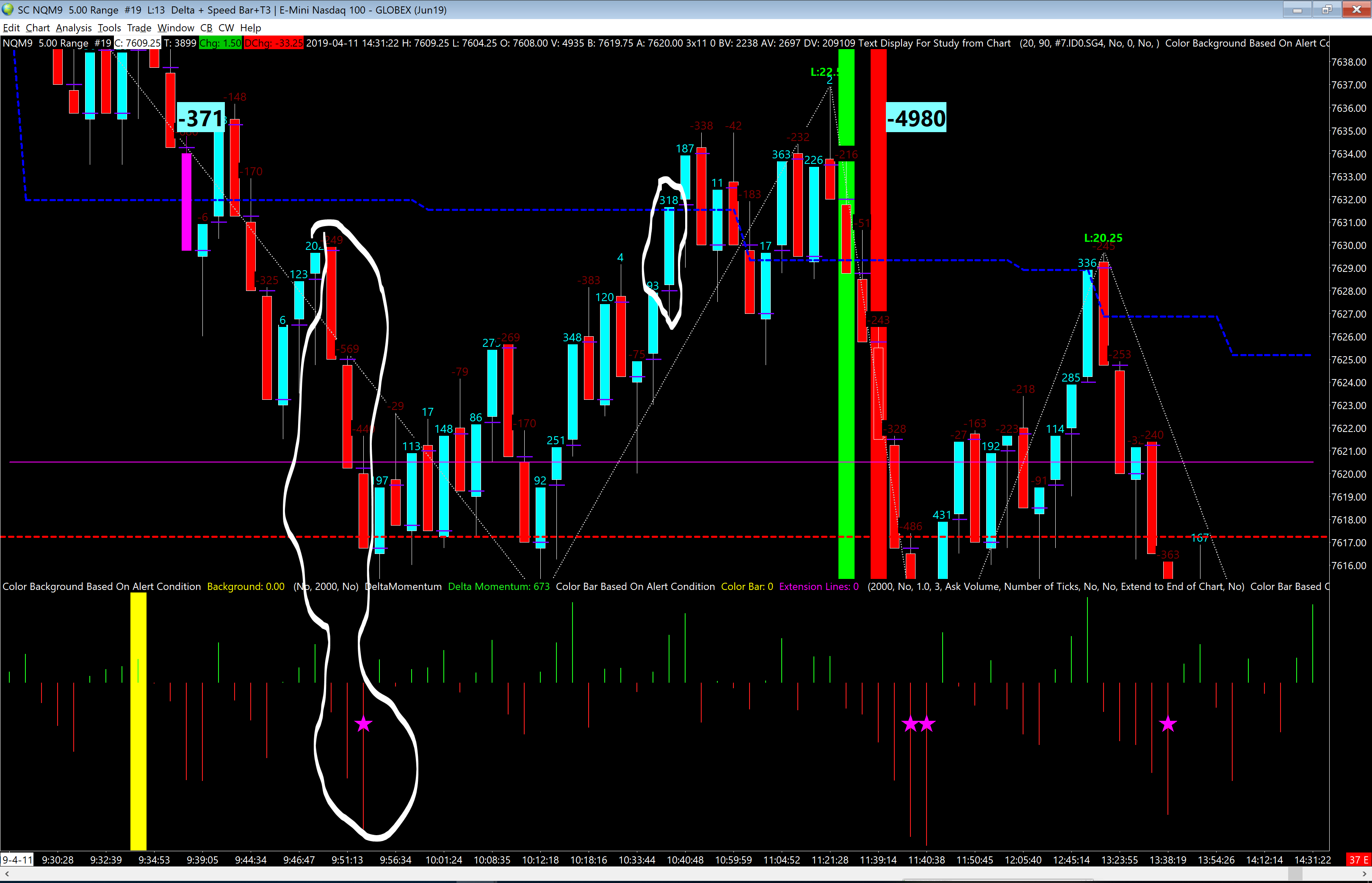

User477191 - Posts: 10
Bradth,
You are close, but we need the signal (SHORT) to generate when price closes below (using range bars) a 3 push up on the delta momentum & opposite for LONG signal.
[2019-04-15 16:29:47]
ForgivingComputers.com - Posts: 1257
I don't understand. Price and Delta Momentum are different scales. How does price close below Delta Momentum?
[2019-04-15 16:39:32]
Bradth,
I have posted a screenshot with an example. I have circled (IN WHITE) a negative delta momentum 3 push down, and then I circle (IN WHITE) a range bar eventually closing above that 3 push down. This would be a (LONG) signal.
Hopefully this paints the picture of what we are trying to achieve.
I appreciate your help!
image3 push close above example.PNG / V - Attached On 2019-04-15 16:38:55 UTC - Size: 355.68 KB - 376 views
[2019-04-15 16:49:19]
That is a bit more complicated. Don't have time to work on that.
