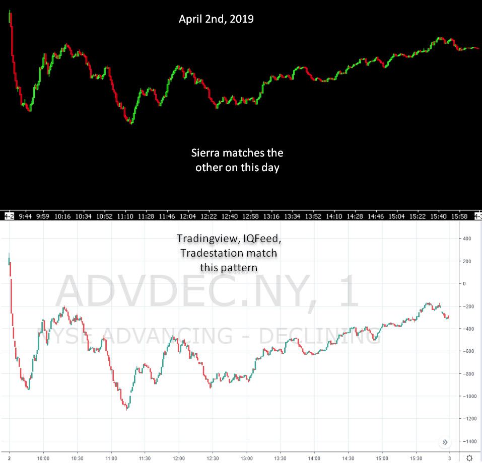

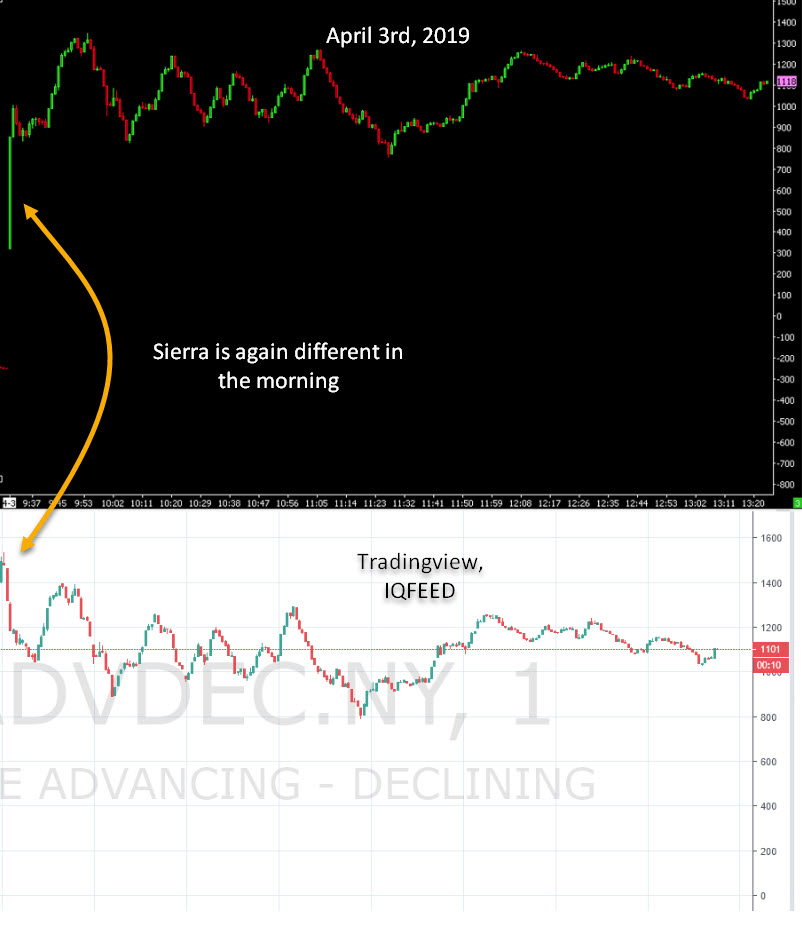

I made a reply in a different post but never got any attention.
I'm asking Sierra support to take a look why NISS-NYSE is completely off from every other place I've checked, including the most reliable IQFEED.
As you can see the issue is only in the morning but since it's completely off it changes the meaning throughout the entire day since high of day as well as low of day values are wrong.
I understand that different providers calculate this differently and that numbers can be off but what's important is the actual graph and if you take a look at the screenshots you will see how different they look.
One thing to note is that on April 2nd they mostly matched with other providers but April 1 and 3 did not.
I'm using Tradingview as an example but I have confirmed that Tradingview matches with IQFEED.
I personally and I'm sure other as well use Adv/Dec to see divergences in various markets and since this isn't showing the proper graph it becomes unusable.

imageApril2_2019.jpg / V - Attached On 2019-04-03 17:35:57 UTC - Size: 116.12 KB - 710 views
imageApril3_2019.jpg / V - Attached On 2019-04-03 17:36:00 UTC - Size: 100.45 KB - 595 views

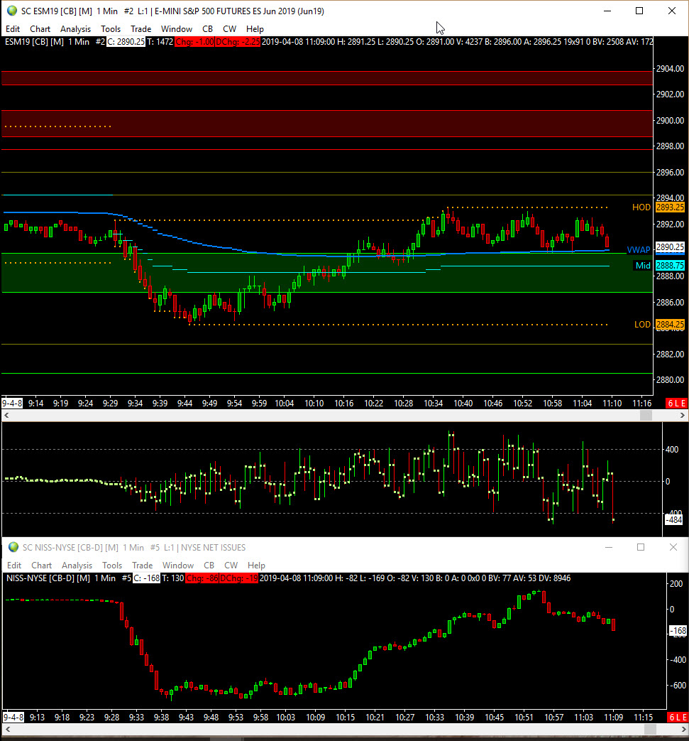

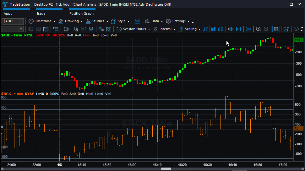

I have compared the Sierra Tick and AD with tradestation and IQfeed ( on IRT )
Iqfeed and tradestation are similar , but Sierra Charts internals are way of.
NYSE Tick is sometimes totally different.
NYSE AD is different at the open of the RTH. After a few minutes, they are the same.
Therefore I use Sierra charts for everything but the internals.
For the internals I have another subscription : Tradestation
This helped me with many trades.
it is a pity that I am obliged to take a second subsription.
Date Time Of Last Edit: 2019-04-09 10:32:23
imageSierra.jpg / V - Attached On 2019-04-09 10:31:30 UTC - Size: 337.31 KB - 677 views
imageTradestation.jpg / V - Attached On 2019-04-09 10:31:37 UTC - Size: 158.48 KB - 673 views
