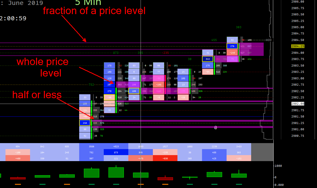

User873570 - Posts: 27
Thank you for this enhancement, it's great. One additional enhancement would make this usable to me in the manner I am looking for. Per the above request:
"...all applied only to the existing %age thresholds and specified min volume setting"
--Alert v2 allows me to do a %age threshold comparison on a diagonal difference ratio. I can use two instances of the study; one for bid, one for ask, to get my different colors. But it appears to NOT do a minimum volume check per cell. This was requested here as well: Using both percentage and minimum Volume diagonal threshold in Volume at Price v2
"3. Allow the user to specify whether the line should be made to stop painting on touch of the level vs on bar close THRU the level"
I'm not sure what methodology is being used right now. For my purposes, I would like the line to stay drawn until a candle closes beyond it, but I cannot tell if this methodology is currently being applied.
With regard to the existing highlight lines, some of them only cover fractions of a whole price level. This does not seem to be by design but I am not sure.
Thank you for your continued consideration.
