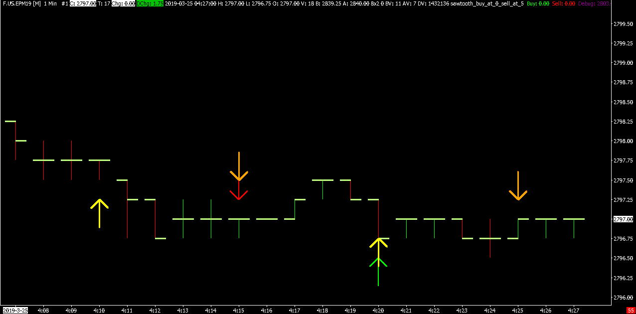

[2019-03-30 18:12:43]
uM8137 - Posts: 183
https://www.dropbox.com/s/aep4v0ufwedtbdu/Screenshot%202019-03-30%2018.48.12.png?dl=0
http://www.sierrachart.com/image.php?Image=1553968643225.png
In this example, I'm trying to understand how this 1min bar simulation fill is not a bug in the backtest fill logic.
In the above chart, the right side orange down-arrow is a SELL simulation order at 2019-March-25, 04:25:00am UTC time on F.US.EPM19.
The trade log (visible on the dropbox screenshot) clearly shows a fill at 2796.50 USD. That price was not observed at all during the 2019-March-25 04:25:00 UTC bar!
The *only* point when price was near that fill was one minute earlier at 4:24. I'm getting "prices from the past". These awarded fills over a minute stale, and very off.
The simulation was done from 2019-March-25T04:00:00 UTC - 2019-March-25T23:55:00 UTC, and the trading system study to reproduce these trades here is a very simple saw tooth test pattern that buys and sells alternatively every 5 minutes. It is pasted below. The data feed for this /ES contract is from CQG, but SierraChart input 1min bars should be identical.
Please let me know if there is any reasonable interpretation. Getting prices from the past is equivalent to predicting on future data. A huge bugaboo.

Date Time Of Last Edit: 2019-03-30 18:20:25
[2019-03-30 21:07:31]
uM8137 - Posts: 183
Ah hah! Adding this code snippet to insist on only processing finished bars
if(sc.GetBarHasClosedStatus(sc.Index) != BHCS_BAR_HAS_CLOSED) {
return;
early in the study, so we leave the function before any orders are placed if the bar is not "closed" yet, substantially addresses the wrong price problem.
