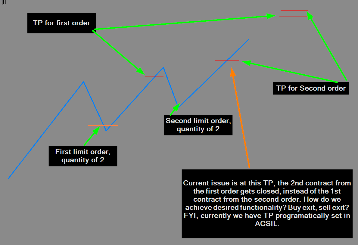

Currently having a small issue with our TP management in acsil, clearly the mistake is on our end, hoping someone can shed light on a solution that has eluded us.
Attached image explains the issue much more concisely than words, please have a look.
Essentially, the situation is that our TP's are closing the incorrect parent orders. Please note, we are not using buyexit or sellexit order actions, but rather setting fixed targets when declaring our s_SCNewOrder object.
Any hints are appreciated.
Thanks!

Perhaps sierra engineering can chime-in. . . How do you keep child orders closing the correct parent orders?
The simple code above just closes orders that are furthest away, with no regard for the parent.
What is the solution: 1) we are missing some sort of setting within sierra, or 2)we must use sellexit to achieve our desired outcome 3) we must use NewOrder.OCOGroup1Quantity and NewOrder.OCOGroup2Quantity 4) we must use or create another function to keep track of all the parent/child orders?
Any assistance is appreciated, we just want to make sure we are headed on the correct path before starting.
