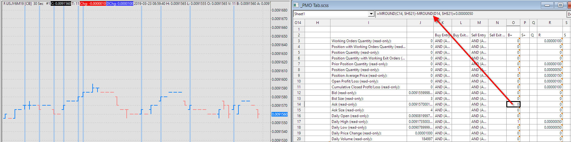

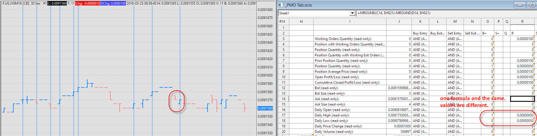

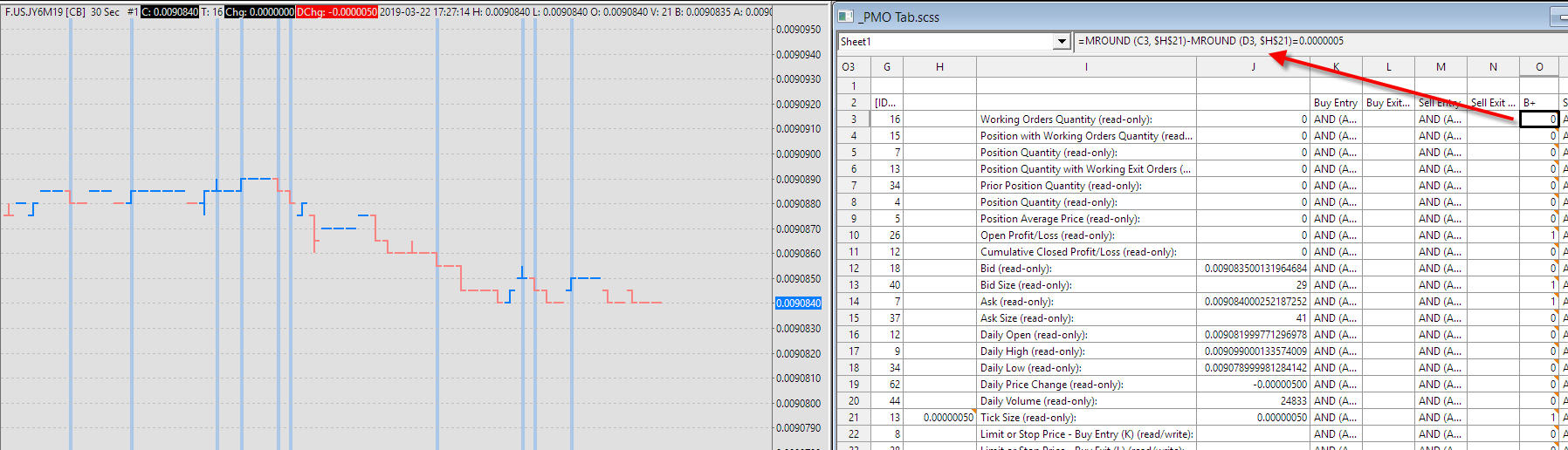

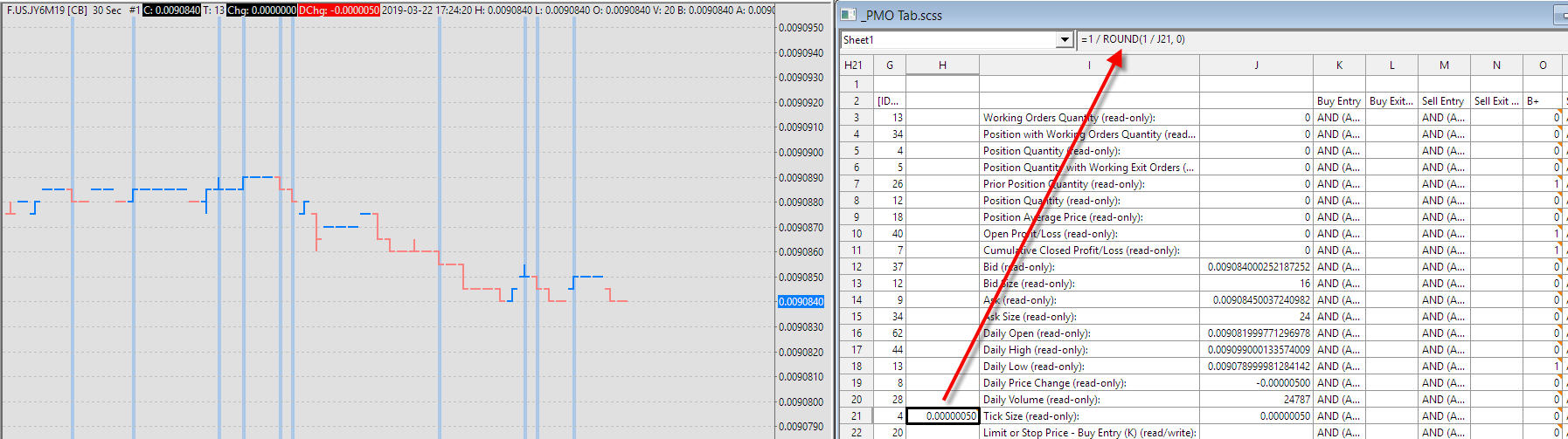

Good day.
On the Japanese yen chart added a table.
In the table I created an alert (B +) highlighting bars of 1 tick size. About Removing Floating Point Imprecision read.
Question: why does the alert not work on all bars? (where is the mistake?)
image11.jpg / V - Attached On 2019-03-22 08:51:51 UTC - Size: 221.46 KB - 402 views
image12.jpg / V - Attached On 2019-03-22 08:51:59 UTC - Size: 230.33 KB - 479 views
image13.jpg / V - Attached On 2019-03-22 08:52:09 UTC - Size: 247.11 KB - 373 views
[2019-03-22 21:00:35]
John - SC Support - Posts: 48143
You need to change how you are handling the final check of the values. How to do this is described here:
Using the Spreadsheet Study: Imprecision of Floating-Point Numbers and Comparisons

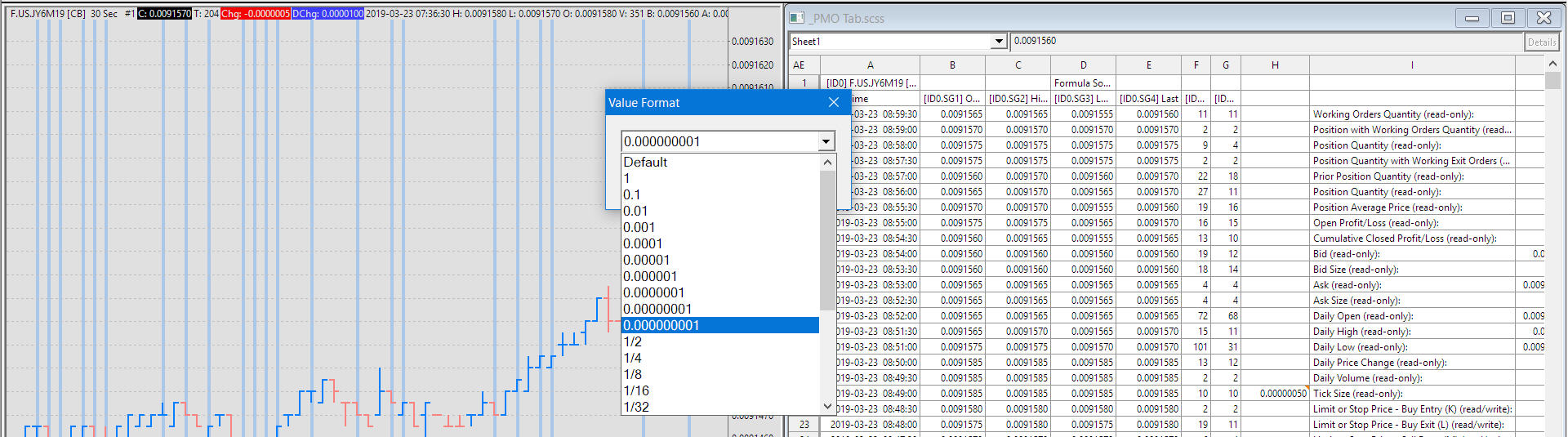

[2019-03-23 09:06:49]
2garin - Posts: 189
The format in the table is set to maximum.
Problem still exists.
How to select all the bars with a size of 1 tick?
Date Time Of Last Edit: 2019-03-23 09:08:17
image14.jpg / V - Attached On 2019-03-23 09:03:36 UTC - Size: 298.87 KB - 393 views

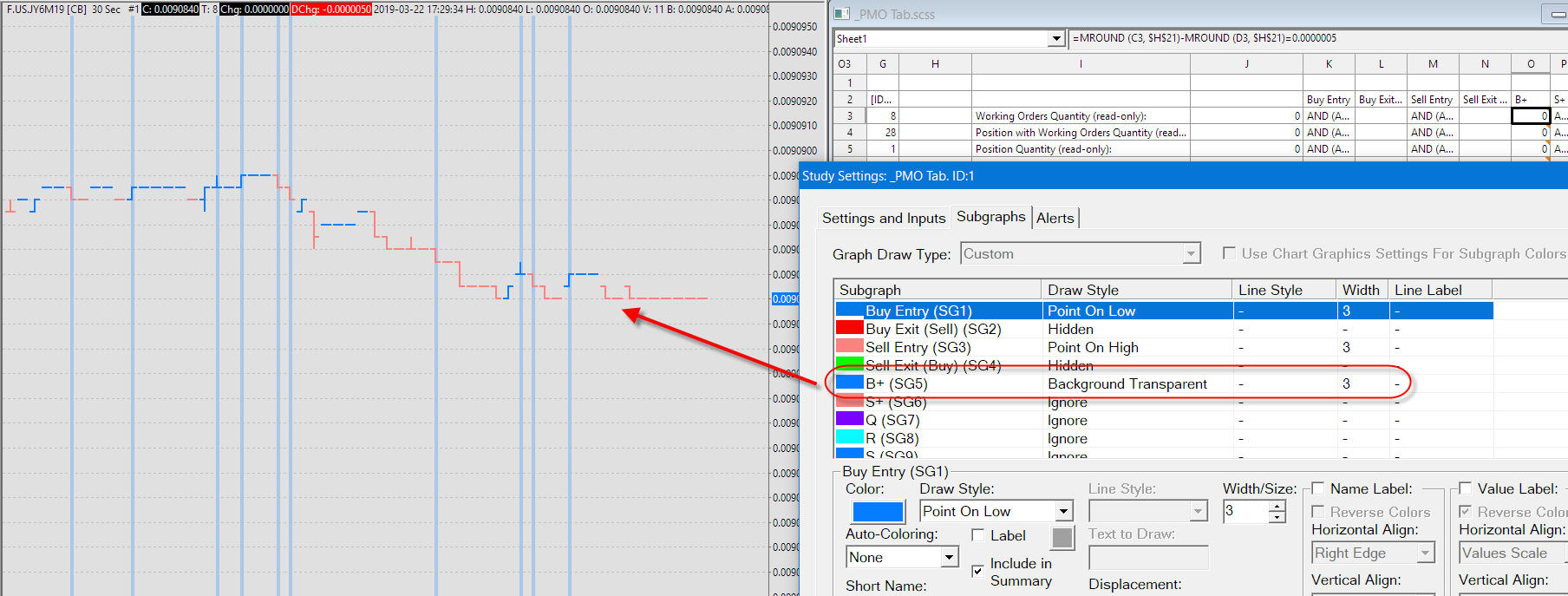

[2019-03-23 09:56:07]
2garin - Posts: 189
image21.jpg / V - Attached On 2019-03-23 09:55:26 UTC - Size: 210.01 KB - 417 views
image22.jpg / V - Attached On 2019-03-23 09:55:44 UTC - Size: 213.64 KB - 376 views
image23.jpg / V - Attached On 2019-03-23 09:55:55 UTC - Size: 222.59 KB - 427 views
[2019-03-25 13:22:01]
You need to change the formula that currently reads MROUND(C14, $H$21) - MROUND(D14, $H$21) = 0.00000050 to state something like the following (you will need to determine the appropriate value to be used):
ABS(C14 - D14) < 0.0000001
Needing to do this is described in the documentation here:

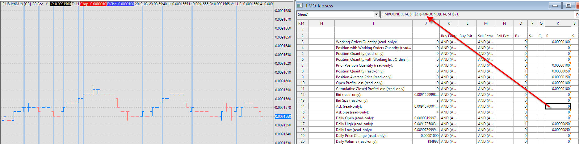

[2019-03-28 22:34:09]
2garin - Posts: 189
The option you offer does not work.
May be useful to other users:
The task to select the bars (screen) with a height of 1 tick was decided by the expression:
=AND (MROUND (C3, $H$21)- MROUND (D3, $H$21)>0.0000004, MROUND (C3, $H$21)- MROUND (D3, $H$21)<0.0000006)
The expression helps to select a bar with a height of 2 ticks:
=MROUND (C3, $H$21)- MROUND (D3, $H$21)=0.000001
The expression is written to the Japanese Yen futures.
image44.jpg / V - Attached On 2019-03-28 22:33:50 UTC - Size: 29.01 KB - 370 views
