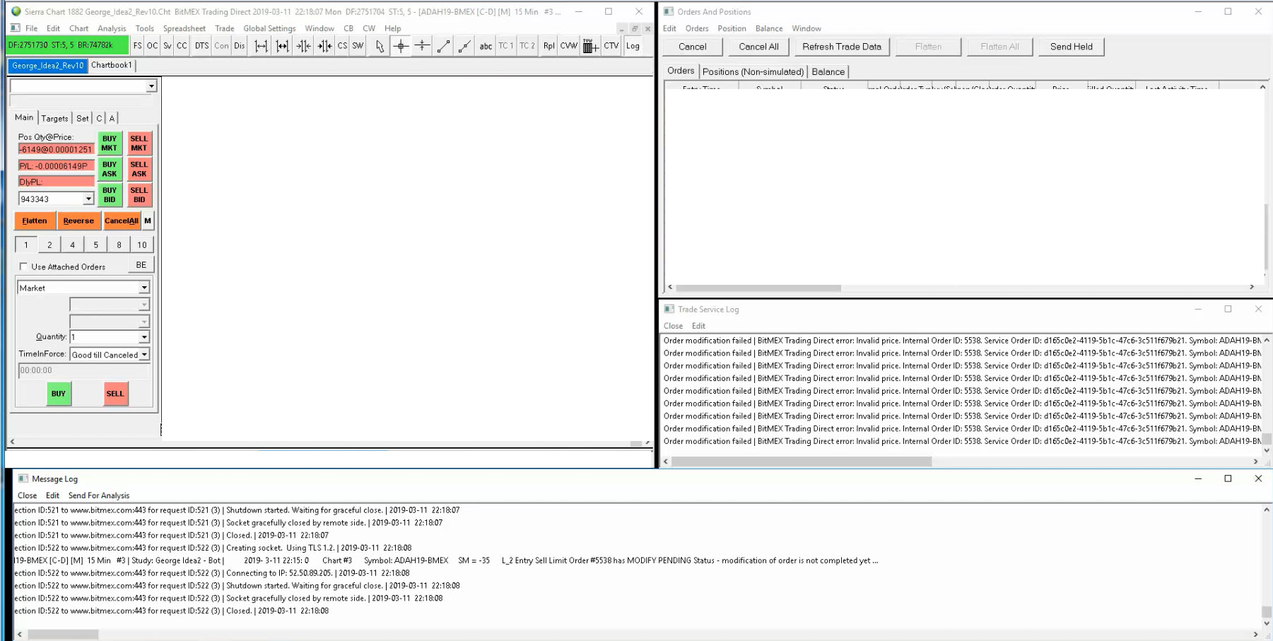

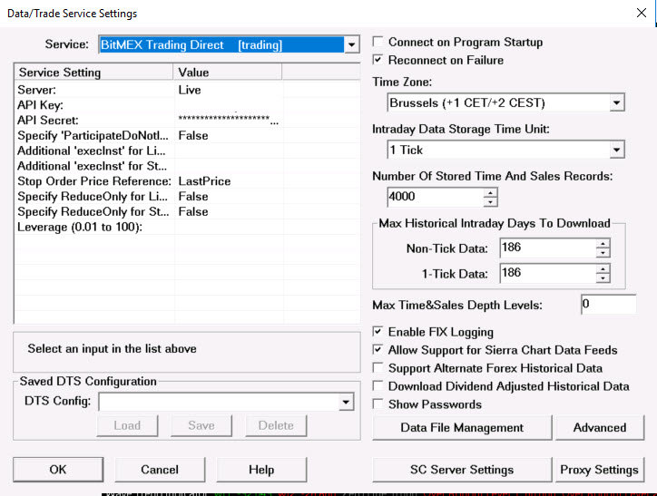

yesterday SierraChart was working with BitMEX good. Reconnect on Failure check-box is always set as you may see on attached screenshot.
But after strong impulse connection to BitMEX was lost and didn't try to reconnect at least 5-6 seconds and I had to connect it manually.
We use bot on SieraChart and it is very important for us to have SC connection attempt at once after disconnect.
How I may tune SierraChart to try reconnect asap? Thanks.

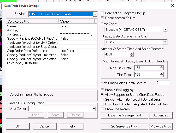

Thanks for your reply!
But as you may see on attached screenshot - Reconnect on Failure is ON, I just had conneced SC, after some time SC lost BitMEX connection and after that didn't try to connect.
I posted part of MessageLog after I manually connected and manually disconnected. But initial problem - SC has switched ON "Reconnect on Failure" setting but after SC lost connection with BitMEX no attempts to connect happened. It was second time foar last few days, so it is very important for us to be sure - SC will try to connect BitMEX if connection will be lost. We had success experience of automatic reconnect with Rithmic and CQG datafeed, with AMP Futurees broker, so it warked nice with CME connections, that is why we are surprised with this situation with BitMEX. Could you help us to avoid this problem? Tell us please what we have to do to fix this problem? Thanks, Alex.
imageto SC support.jpg / V - Attached On 2019-03-12 12:26:05 UTC - Size: 114.26 KB - 516 views

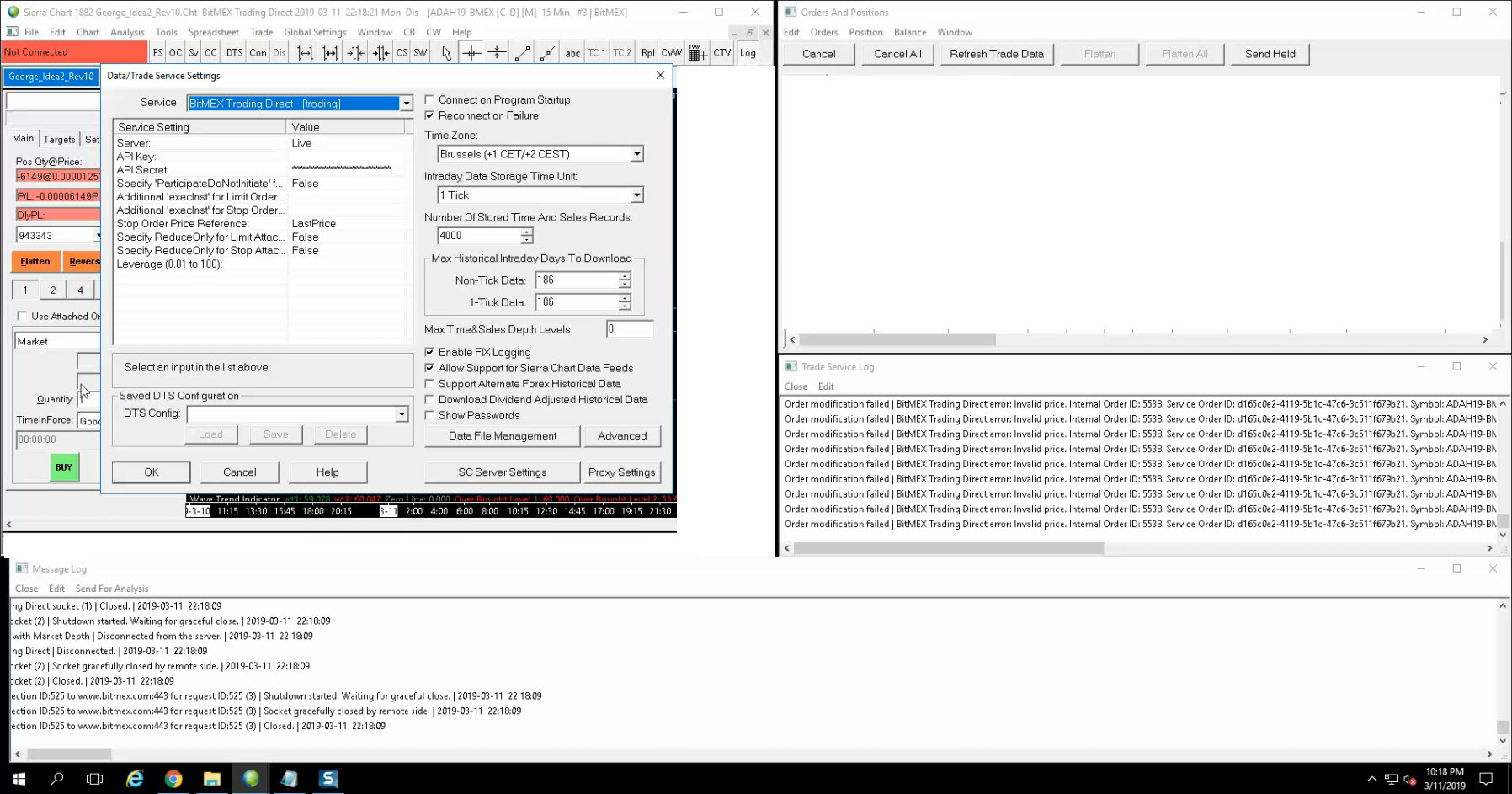

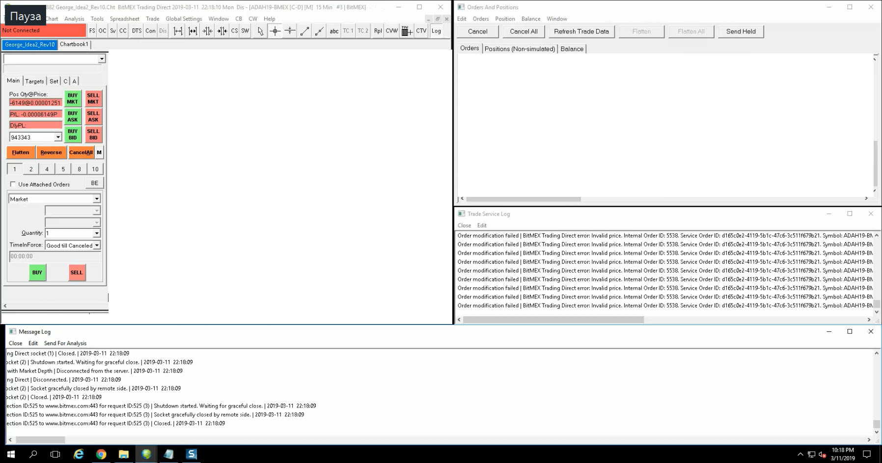

I have only video https://youtu.be/RhhRLDp7YJw with MessageLog window - I tuned Save Message Log to file after that situation. it is private trade system of my customer so I hided chart. You may see disconnect at 02:00 of video. Hope it is enough to understand a cause of problem with absent reconnect procedure. Thanks! Waiting for your reply, Alex.
[2019-03-12 20:16:49]
User517260 - Posts: 97
Oh, pardon, I forgot you are not allowed to send video - please look into attached screenshots - you may see timing from 22:18:08 (SC still connected to BitMEX), 22:18:09 - disconnected, 22:18:10 - disconnected
imageReconnect absent problem 22 18 08.jpg / V - Attached On 2019-03-12 20:15:09 UTC - Size: 265.31 KB - 424 views
imageReconnect absent problem 22 18 09.jpg / V - Attached On 2019-03-12 20:15:17 UTC - Size: 246.75 KB - 694 views
imageReconnect absent problem 22 18 10.jpg / V - Attached On 2019-03-12 20:15:23 UTC - Size: 246.52 KB - 541 views

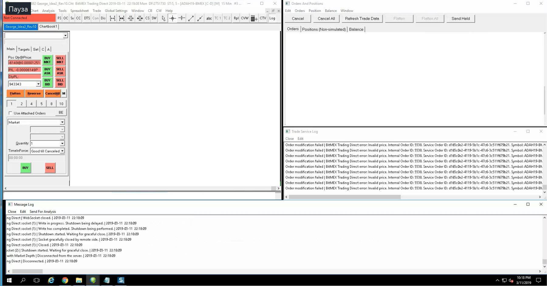

[2019-03-12 20:19:08]
and at 22:08:51 SC was still disconnected - no attempts to connect during 42+ seconds, so I had to start connect manually.
Please help us to avoid this problem because my customer will avoid me ))))
Alex.
imageReconnect absent problem 22 18 51.jpg / V - Attached On 2019-03-12 20:18:13 UTC - Size: 304.38 KB - 470 views
