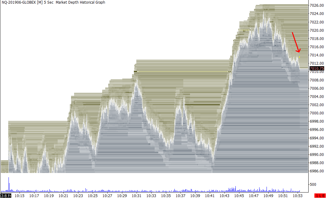

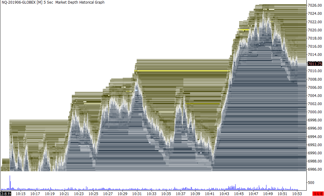

I'm trying to figure out good settings for this study. It seems like no matter what I do, its not pleasing. One particular issues deals with scrolling. When you encounter some outrageous BID/ASK, all the colors change. Please refer to images C and D, and I mark at D that one ASK which flashed causing colors to readjust. This issue becomes apparent especially when you have 2 charts beside eachother but different time frames. (ie. A 1 minute chart which is showing 2 hours, and a 5 second chart which might only show 20 minutes. Because the 5 second chart might not have some thick levels displayed, the colors re-calculate and look different)

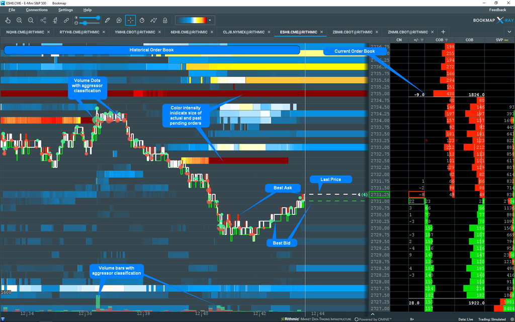

I'm not sure if this can be fixed via just better settings, or if it needs extra inputs or improvement from Sierra. In the last attachment, I show a screenshot from Bookmap which visually appears excellent.

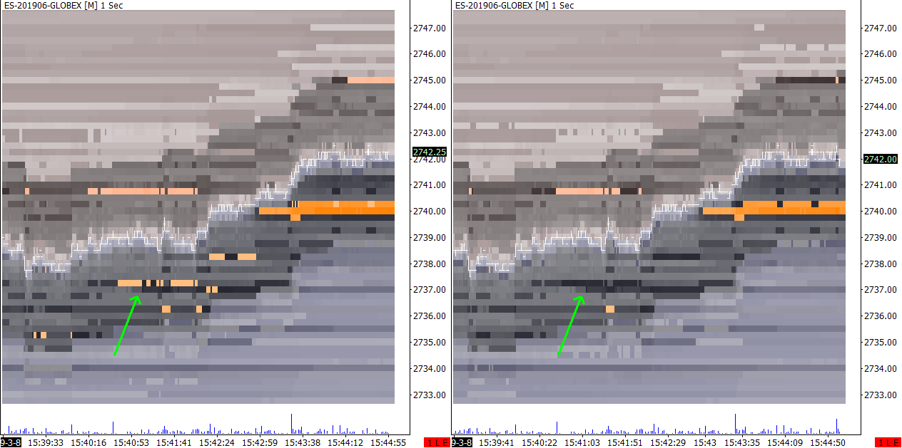

One more example.
On the left is an area highlighted via green arrow which shows a level that is thicker than others so I decided to color it orange. But when you scroll a couple of bars to the right, this color all of a sudden drops out just because of some other BIDs/ASKs which popped in from the scrolling. There are a few other areas on this chart where the colors drastically change.
