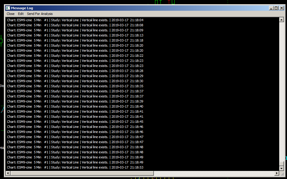

[2019-03-18 04:26:31]
HAB-User115006 - Posts: 38
Ackin: The study works great but I am seeing these messages in the Message Log, I think on every tick, do you know what this is? Is there anything in your source code that needs changes? I have attached a screen shot
imageScreen Shot 2019-03-17 at 9.18.55 PM.png / V - Attached On 2019-03-18 04:22:50 UTC - Size: 98.77 KB - 979 views
[2019-03-19 14:08:11]
Ackin: Ok, great, please let me know or send the function, I think you are writing to the log every sec/tick, definately using up a lot of CPU on my PC
[2019-03-20 07:36:36]
All good, Thanks
