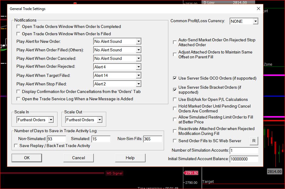

[2019-03-14 10:48:24]
User906279 - Posts: 9
I do believe I have the correct settings.
imageTrade settings.JPG / V - Attached On 2019-03-14 10:48:03 UTC - Size: 126.16 KB - 432 views
[2019-03-14 20:36:56]
I did not get a response regarding the last email. oco orders are doing the same some times they work and other times they don't I did attach the current setting which I think are correct please advise.
[2019-03-14 20:42:58]
We just have not gotten to this yet. You do have the correct setting enabled.

[2019-03-14 23:32:44]
Definitely server-side OCO is being used:
Attached Order | Client side bracket order | Server side OCO order
So any rejections due to margin, would have to be resolved by your broker with risk settings.
