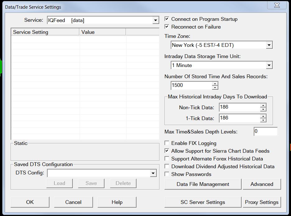

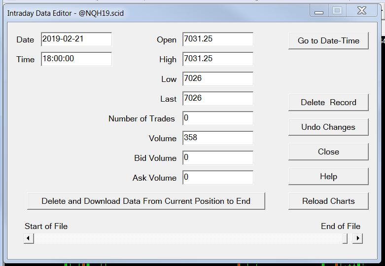

Starting with version 1875 & higher there is an issue when using the (Delete and Download Data From Current Position to End) tab in the (Intraday Data Editor .... 5 hours of Data will be missing).
The problem only happens if the (Intraday Data Storage Time Unit)drop down window is set to anything > than 5 seconds in the (Data/Trade Service Settings).
I do have my (Data/Trade Service Settings) normally set to (1 TICK), but at the end of the trading week I will edit symbols that I have no need for TICK data.
When I roll back to my previous version (1865) the editor works fine.

[2019-02-25 20:47:43]
We do see the reason for the problem and we are resolving it now.
