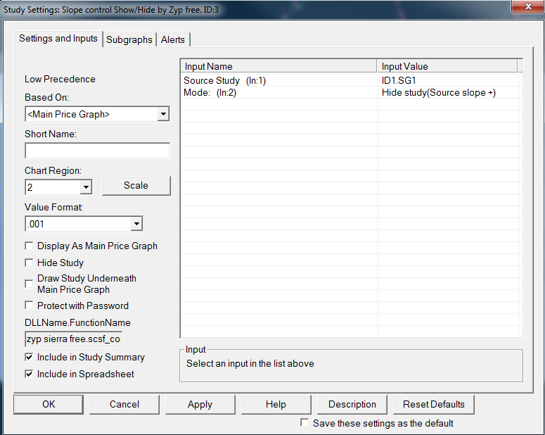

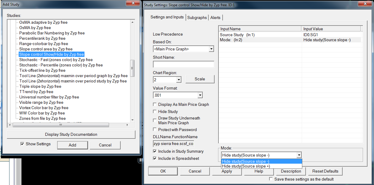

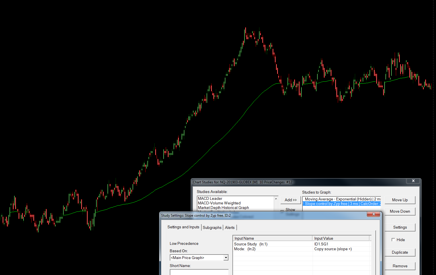

Ackin - Posts: 1865
via ACSIL download free dll
Ackin's indicators (SCH users requests for studies) - Update list | Post: 170827
edit:
Study slope control
source: some study (hidden)
control (copies part of the source curve) by slope
Study slope control 2
output: the same
control (show/hide study) by slope

imageslope control.png / V - Attached On 2019-02-09 16:53:24 UTC - Size: 81.69 KB - 911 views
imageslope control2.png / V - Attached On 2019-02-09 17:23:12 UTC - Size: 51.57 KB - 863 views
imageadd study.png / V - Attached On 2019-02-09 23:49:33 UTC - Size: 105.92 KB - 826 views
