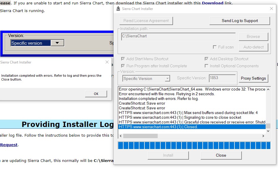

I tried rolling back to version 1853 with no success. I used the Sierra Installer (see attachment) and got an error. I also attached the log file. Is the only way to install version 1853 is thru the Installer?

[2019-02-12 20:28:34]
There is no need to go back to a previous version at this time. We have added the required option. Update to the latest prerelease:
If you have a problem updating let us know.

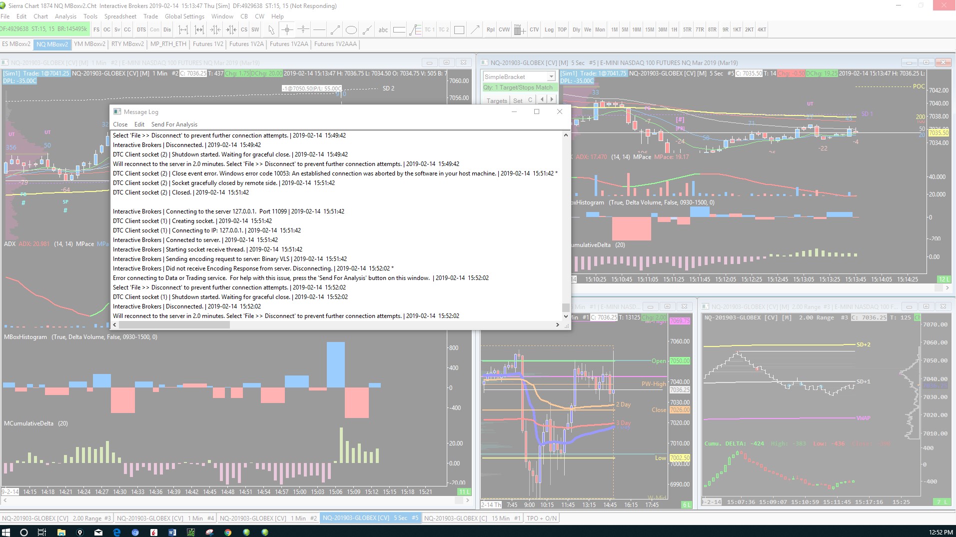

per the recommendation on this support thread, I installed the prelease version (version 1874) earlier this week. I noticed today that Sierra Chart instance #1 did not respond after running for about 2 hours (see attachment). This happened twice today. Because it was unresponsive, I had to use the Windows Task Manager to kill the process. For Sierra Chart instance #2, I was able to close it by clicking on exit.
I did not see any logs created today (Feb 14, 2019) under SierraChart -> logs folder. The last log file was created on Feb 12, 2019
imageConnection Socket Issue.jpg / V - Attached On 2019-02-14 21:04:51 UTC - Size: 412.9 KB - 392 views
[2019-02-14 21:09:16]
We are looking into this.
[2019-02-14 22:07:46]
The not responding condition has been discovered and resolved and we are going to be releasing a new version in about 20 to 30 minutes. It will be version 1875. We do apologize for the issue.
Date Time Of Last Edit: 2019-02-14 22:08:27
