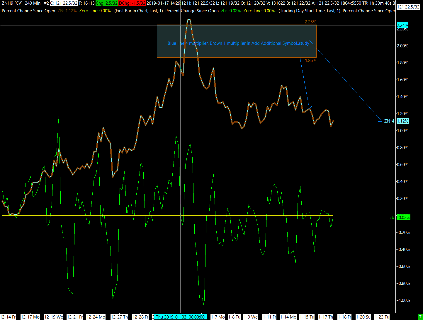

User63632 - Posts: 43
Attached is chart book and screen shot requested. You will see a brown line wider than the blue line. In the ADD Additional symbol study,1 ZN contact has multiplier of 4 while the other ZN has multiplier of 1 ,yet they are identical in percent change. Thank you
http://www.sierrachart.com/image.php?Image=1547753360944.png
attachment%change .Cht - Attached On 2019-01-17 19:12:58 UTC - Size: 76.8 KB - 465 views
[2019-01-17 23:10:59]
We found the initial problem with the Multiplier and have fixed it. It will now adjust the calculated Percentages for the given data (it will act as you expected it to). This will be in the next Pre-Release (v 1863). When available, you can update following these instructions:
