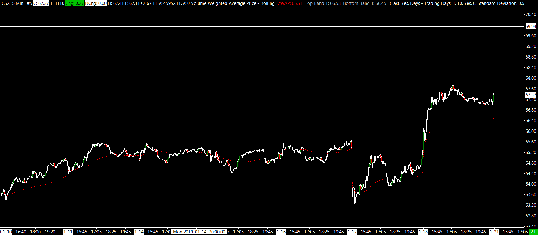

Struggling to get vwap to correlate with vwap setting from ib chart.
Screenshot gives sc vwap red line, the blue dash is where ib vwap was at that time, 5 minute chart 1745 gmt, sc showing vwap 20.03 ib showing 20.28

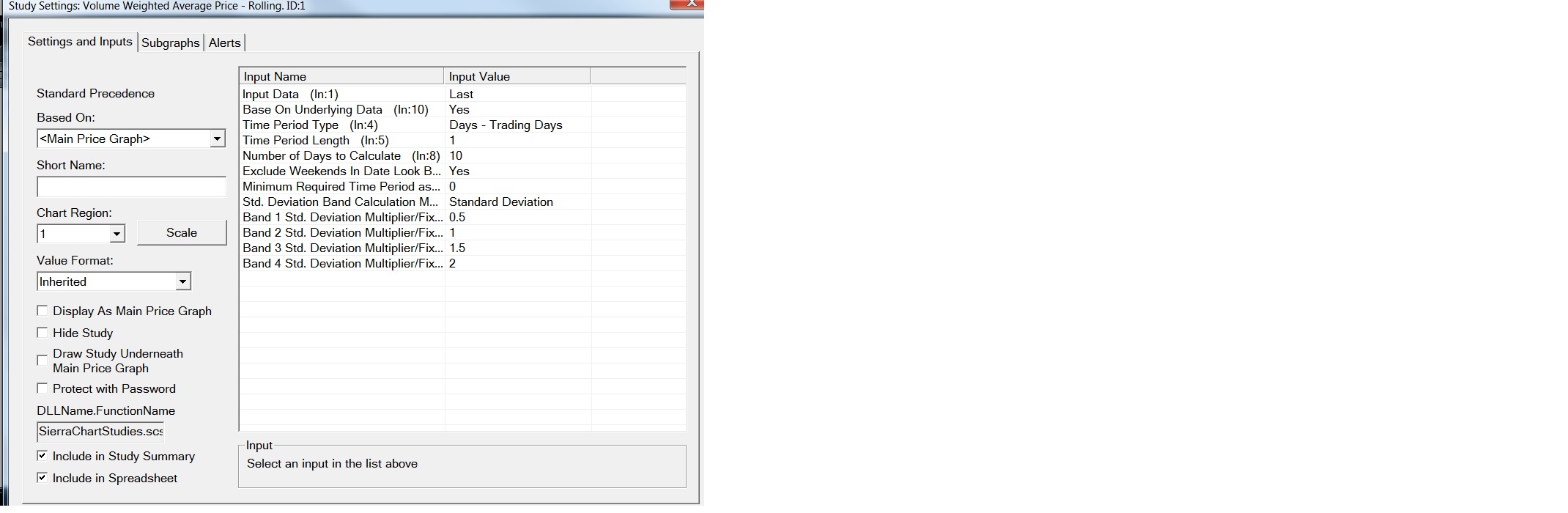

study settings
input data = last
base on underlying =yes
time period type = days trading days
time period length =1
number day to calculate =10
Std. Deviation band calculated = standard deviation
http://www.sierrachart.com/image.php?Image=1547488473853.png
Where am I going wrong?
imagesettings.jpg / V - Attached On 2019-01-14 18:01:49 UTC - Size: 197.12 KB - 428 views

http://www.sierrachart.com/image.php?Image=1547914833825.png
Here is another example and not all charts do this!
Data was from sc not ib but appears the same from about 15:20 uk time vwap flattens
This may reset a day later perhaps as vwap is what it should be for previous days, but not much good for day trading
