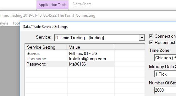

hello,
I reopened my account with AMP, they sent me credentials but i can't connect with them to my siera.
I contacted the AMP support and they double checked that it is enabled on their end. Also i was able to connect to RTrader (ritmic platform) so they told me i should contact u to ask what is wrong there.
the screenshot shows the setup on my sierra - it should work
can u tell me what is wrong?

[2019-01-10 17:21:18]
Provide a copy of the Message Log by following these instructions:

[2019-01-11 18:45:00]
This is the relevant message:
Rithmic Trading | Message from server: Server Alert: Market Data Connection Login Failed. Result text: "permission denied" | 2019-01-11 03:43:22
Refer to:
Rithmic Trading Platform Service: Permission Denied Resolution Procedure
