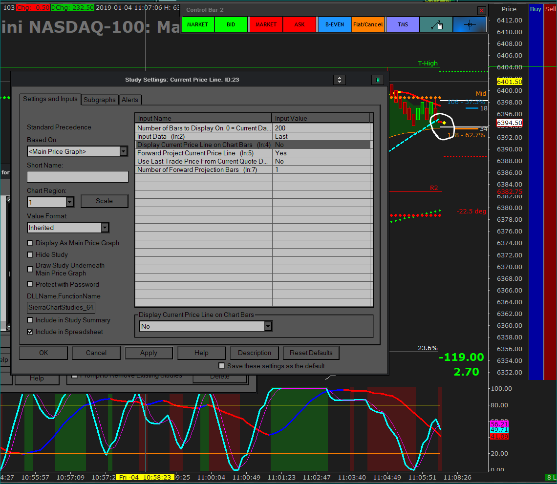

[2019-01-04 16:10:16]
Xfanman1 - Posts: 320
The best I could do was get it to display one bar forward of the current price (See Attachment), not ON the actual candle or bar. I thought that turning Number of Bars to Display to 0 should do that but that didn't work when I tried. Maybe SC Support will chime in.

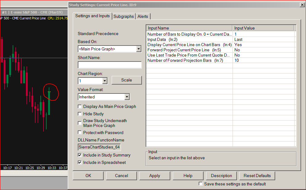

[2019-01-04 16:42:45]
Sawtooth - Posts: 4362
Try this:
Set 'Number of Bars to Display On' to 1
Set 'Forward Project Current Price Line' to No.
The Draw Style in the pic is Dash.
imageCurrent Price Line.PNG / V - Attached On 2019-01-04 16:42:22 UTC - Size: 50.49 KB - 722 views
[2019-01-04 16:52:07]
grantx - Posts: 244
It works!! Thank you so much Xfanman and tomgilb.
