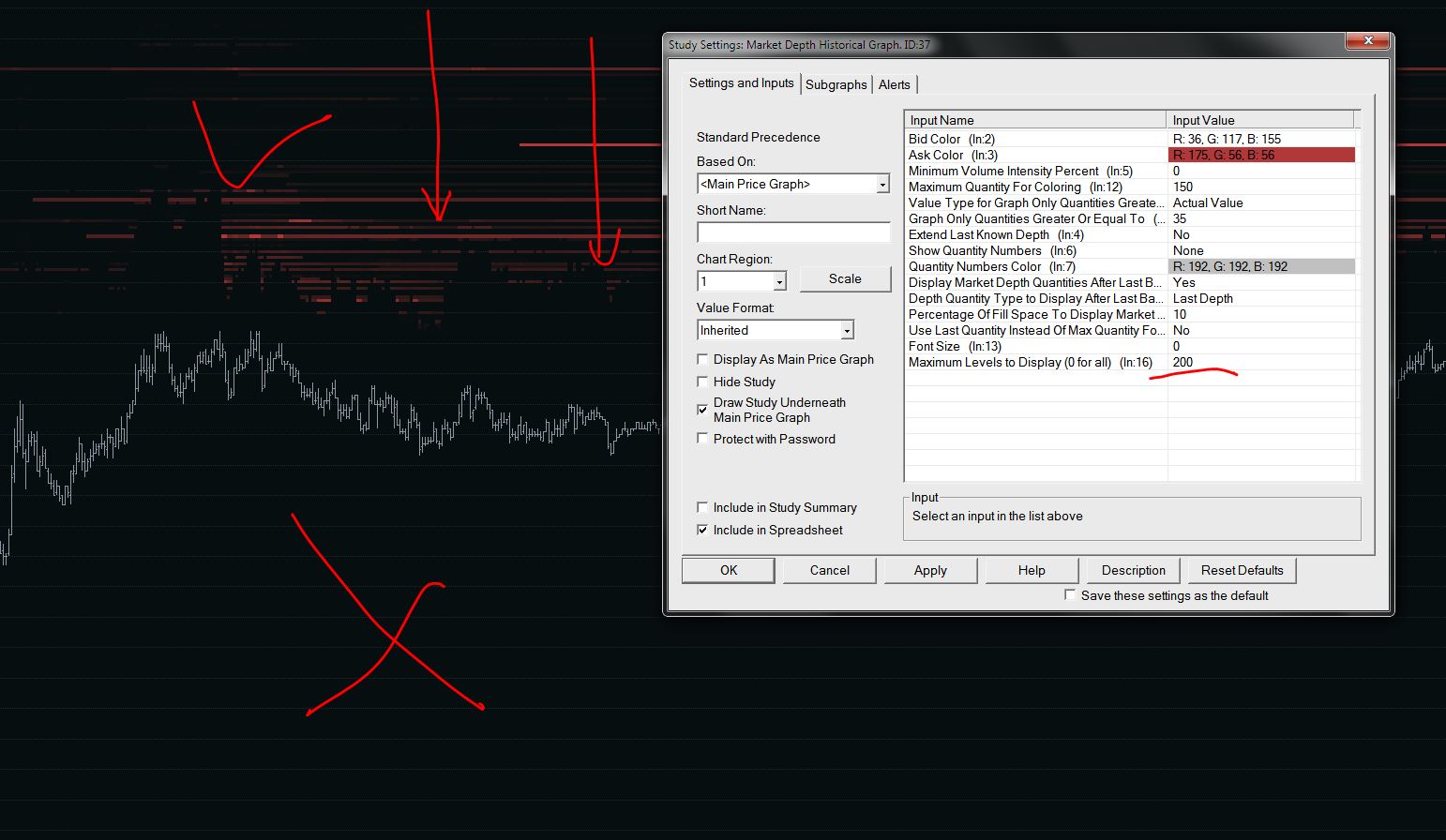

Yes I use 1863. Example in screenshot
Private File

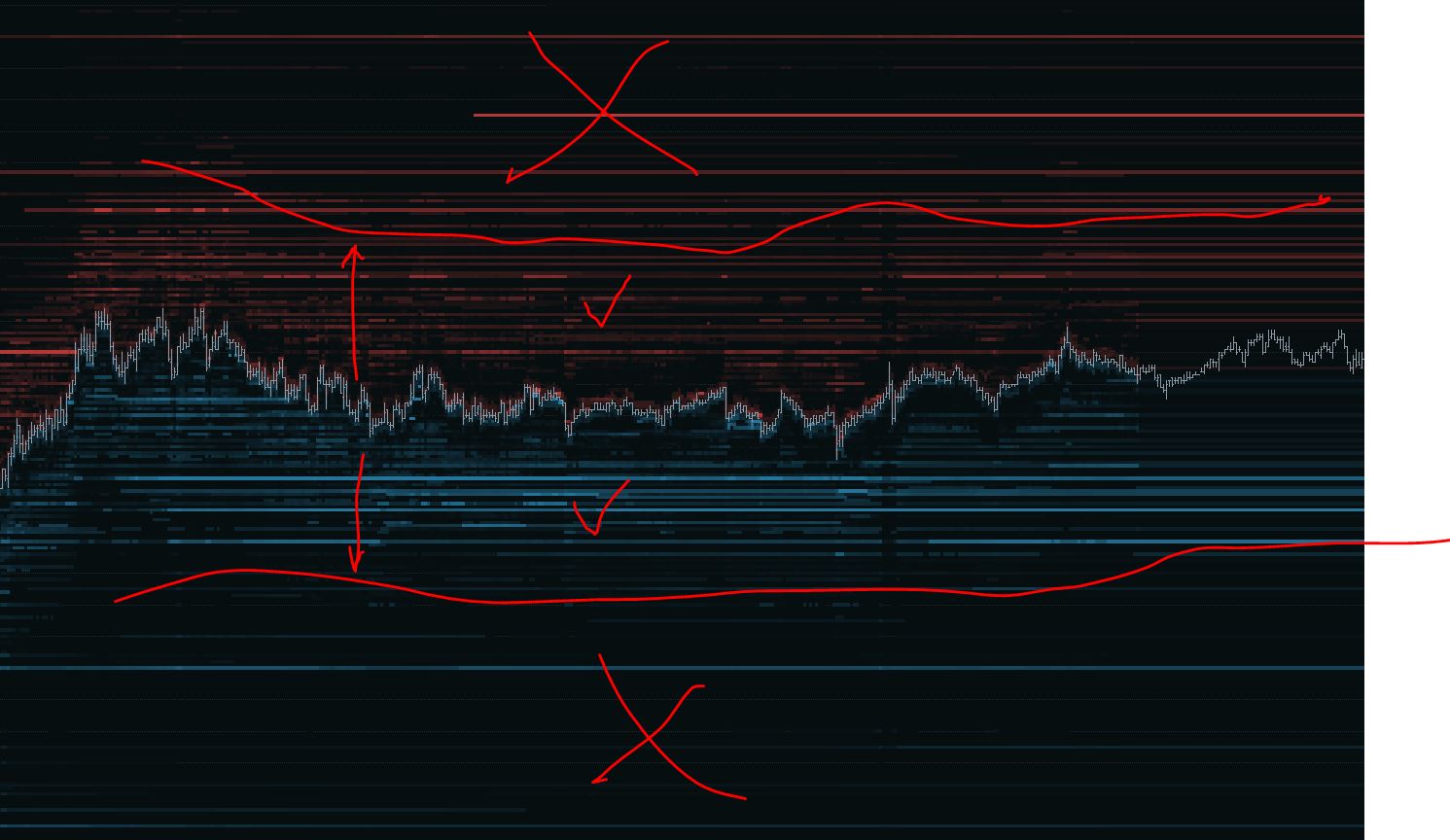

Ok I see your problem. When input is 300 for example you show top 300 offer levels farthest from price --> Screenshot1
This setting should be price-centric. So if I enter 50 I expect to see 50 bids and 50 offers levels closest to the price --> Screenshot2
imagedepth_as_is.JPG / V - Attached On 2019-01-21 08:52:49 UTC - Size: 178.87 KB - 477 views

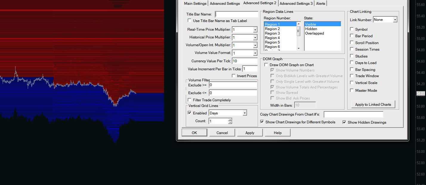

One other thing we noticed is that if you use a Real-Time Price Multiplier and do not adjust the Tick Size accordingly, then this will cause the Market Depth at the top or bottom to be displayed rather than centered on the Last price value. Please check to see if this is possibly the reason you are seeing what you are.
Refer to the following information about changing the Tick Size when adjusting the Real-Time Price Multiplier:
Chart Settings: Real-Time Price Multiplier (Chart >> Chart Settings >> Symbol >> Symbol Settings menu)

My chart settings are standard for crude. No modifications there. Also settings for depth study colors are not a problem here (i set both to 0 as you asked).

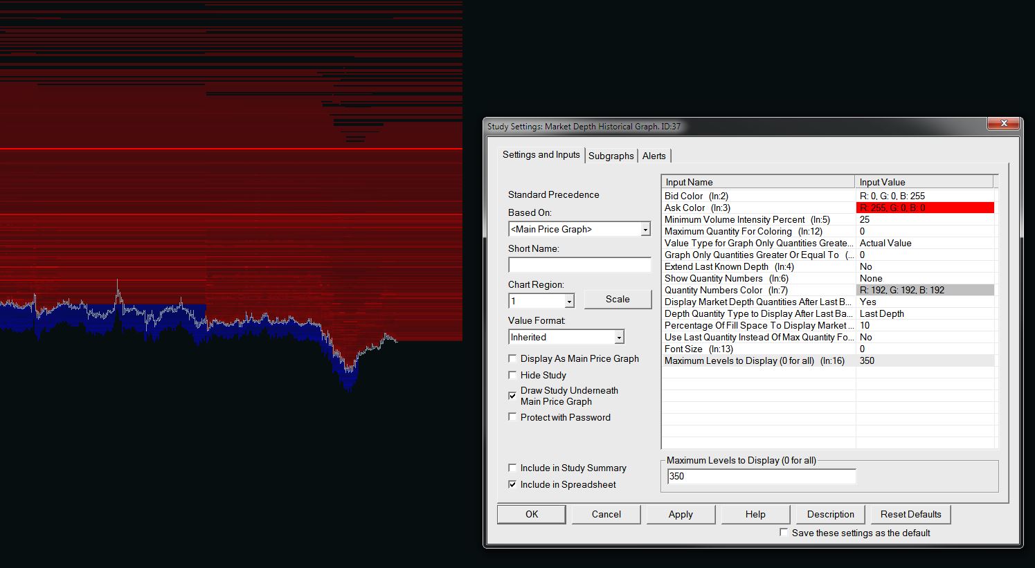

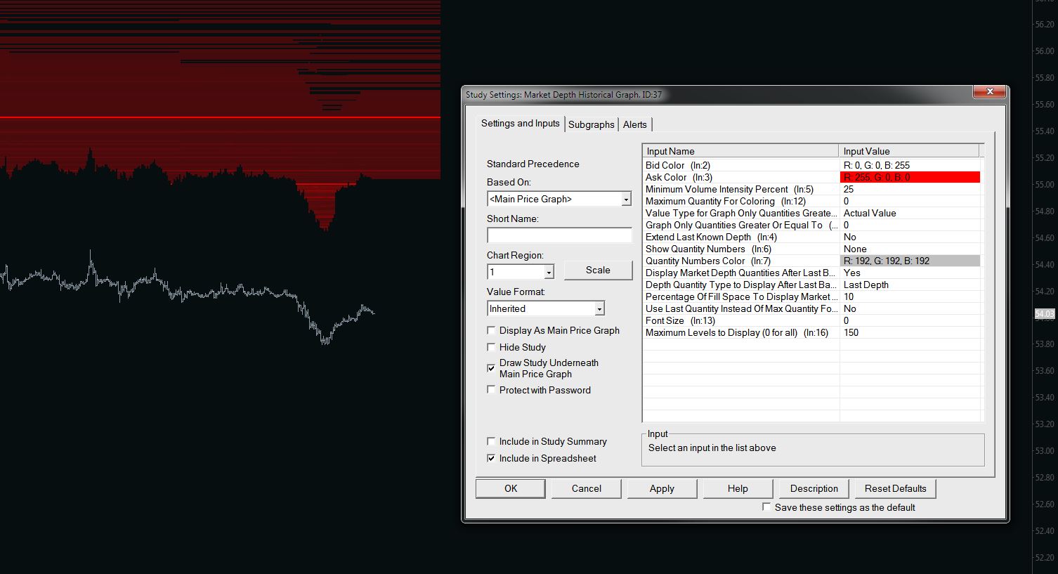

Here you have some screens with different levels setting. No real logic there.
Also im not sure about your number of levels exlpanation. If I set it to 200 I expect to have 100 bids and 100 offers starting from current price. Of course it doesnt mean that it will show all 100 prices up and down as depth at some prices can be zero so it should iterate all 100 available levels from price up/down. It should be excatly same logic as in sc.GetAskMarketDepthEntryAtLevel() and sc.GetBidMarketDepthEntryAtLevel() and where I can call sc.GetAskMarketDepthNumberOfLevels() function to look for actual depth levels available here you should just set this as constant value (study input) and just iterate up and down from price.
imagesettings.JPG / V - Attached On 2019-01-21 21:02:25 UTC - Size: 119.43 KB - 477 views
imaged1.JPG / V - Attached On 2019-01-21 21:02:30 UTC - Size: 148.11 KB - 442 views
imaged3.JPG / V - Attached On 2019-01-21 21:03:52 UTC - Size: 156.96 KB - 488 views
