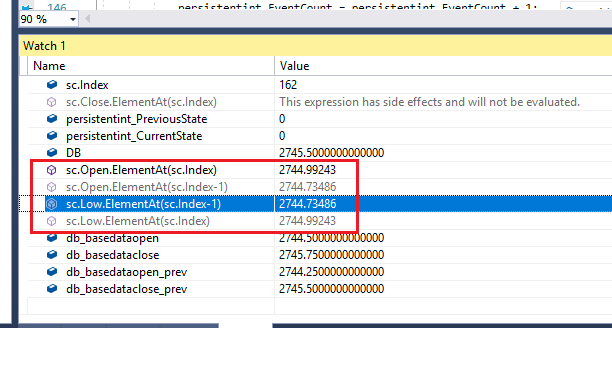

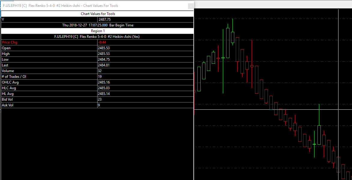

when using these arrays to access the true price data in ACSIL...i get stuff like 2744.84, 2745.17, 2634.62.
These erroneous/distorted values even show in the "Chart Values for Tools" window under the "Open","High","Low"..etc fields.

here's a screen shot showing wrong data using ACSIL sc.Low[] and sc.Open[]

[2018-12-28 03:42:31]
The problem is you have set the Heiken-Ashi study to be the main price graph and that is changing the values. You have to remove that study.
Date Time Of Last Edit: 2018-12-28 03:42:52
