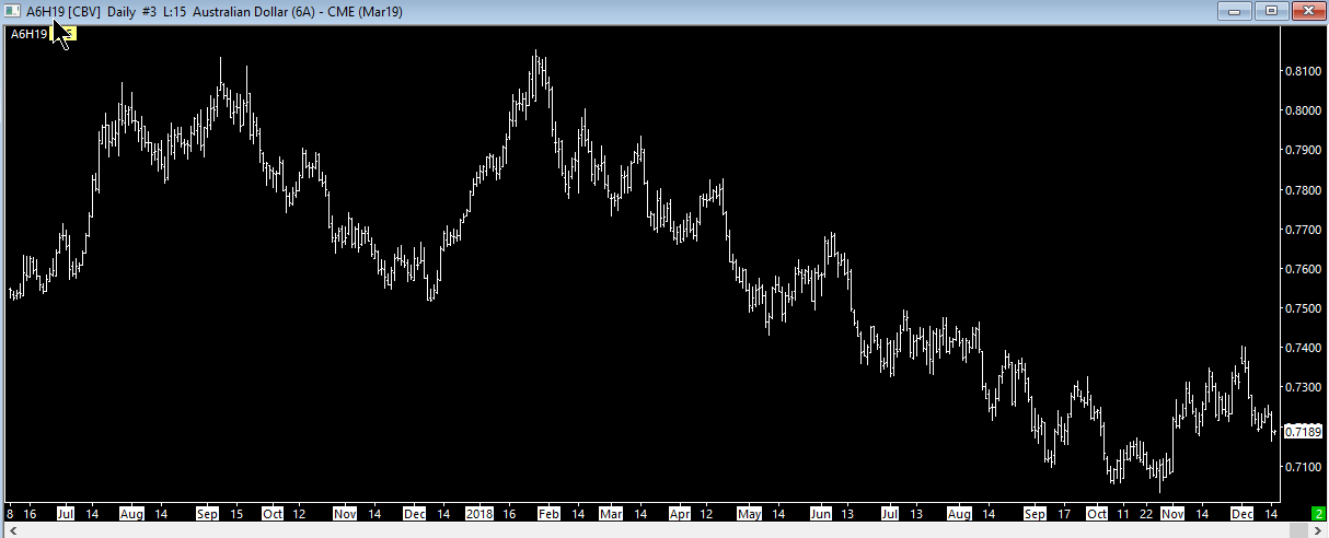

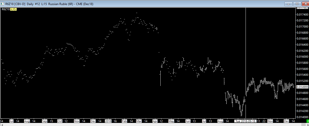

I've attached two screenshots. One of the CME Ruble contract & another of the AUD/USD contract. I can understand that the AUD may be more liquid so there are more prints, but how come the R6 contract is dotted up until we reach the current month? I have set this to a continuous contract with volume-based rollover --- shouldn't even the ruble show more consistent prints since it grabs all the data from the previous months? If it trades so sporadically wouldn't the Sept/Oct/Nov/Dec data also be 'dotted'?
Just curious how this works and what's happening with the contract data.

[2018-12-17 23:15:29]
We had to set up the rollover rules for that ruble futures contract. This is now done.
After the above is done reload the chart with Chart >> Reload.

Ah cool, I can see it's changed now. It's similar with KDZ18 (korean won), MQ (mexican peso) & NR (norwegian krone). Is that due to just hardly any prints or symbol settings? out of curiosity what change did you make?
