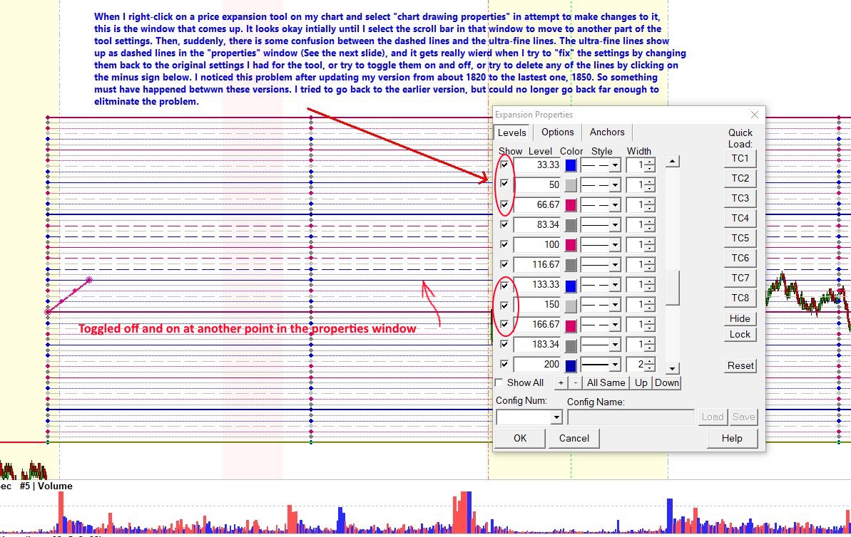

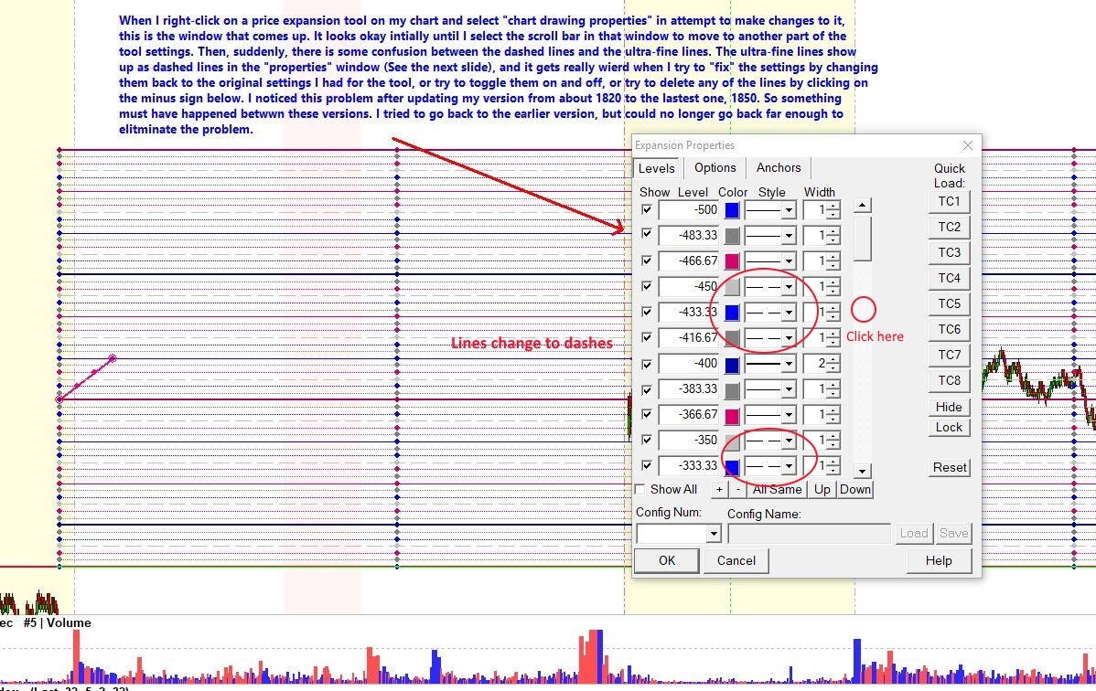

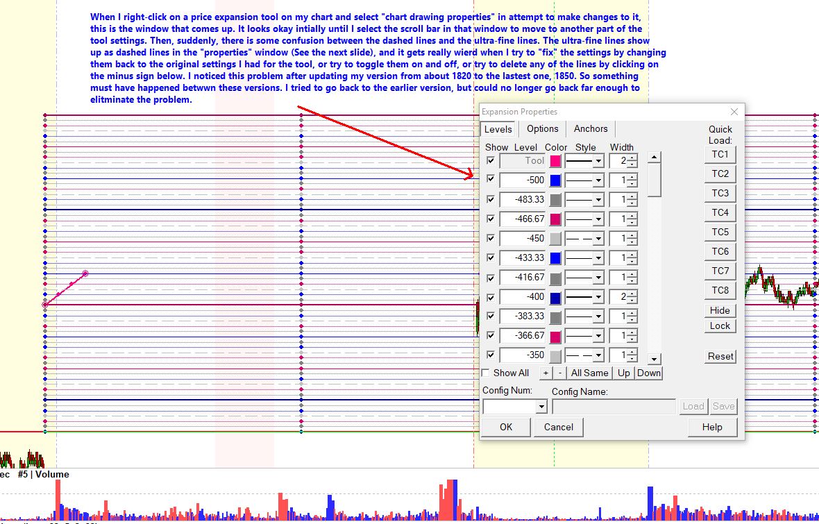

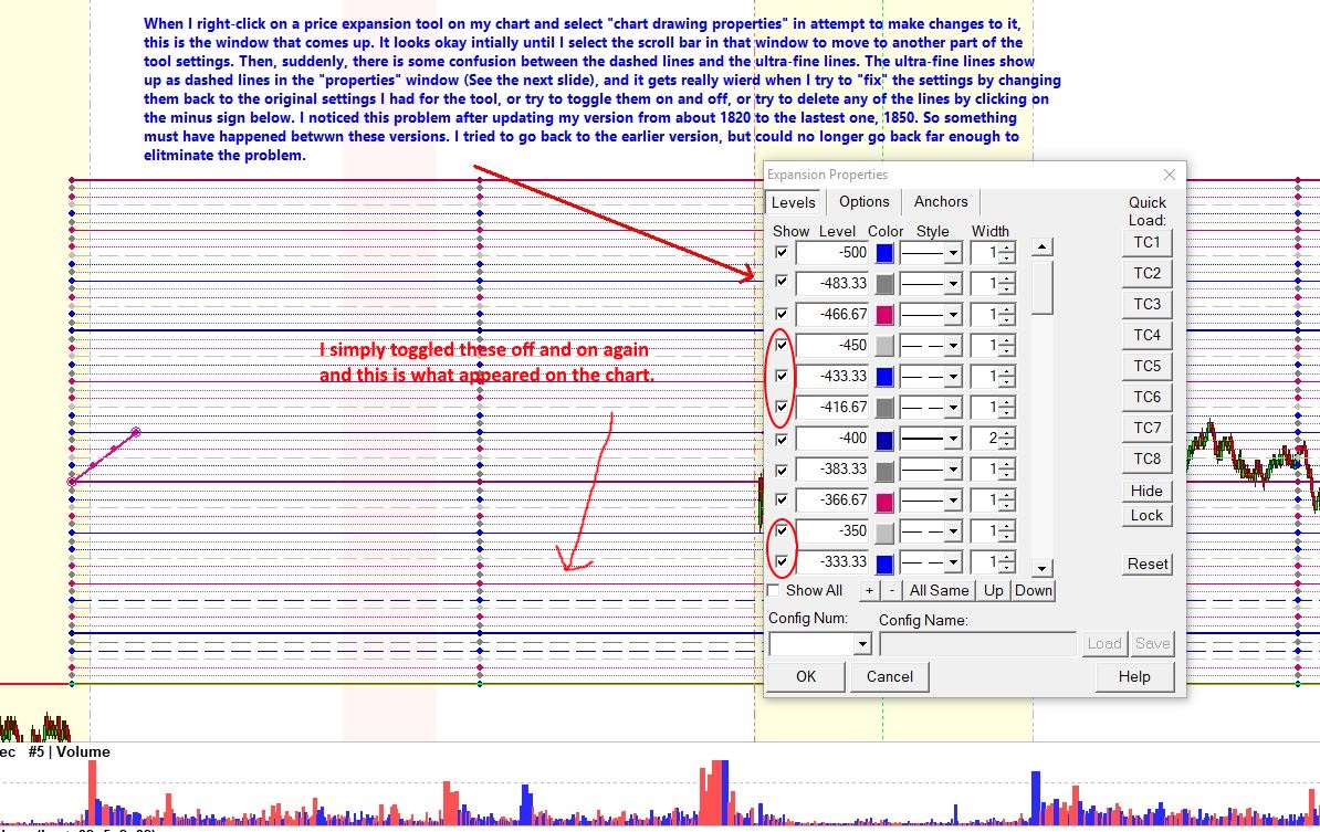

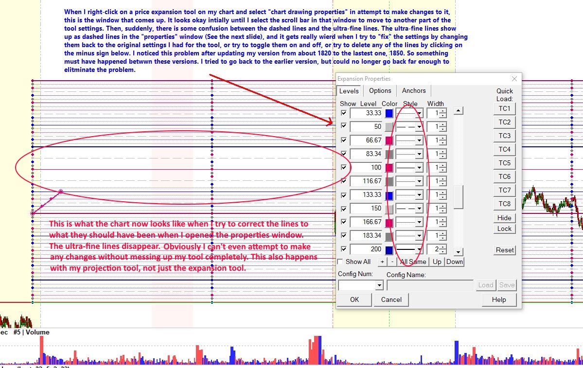

When I right-click on a price expansion tool on my chart and select "chart drawing properties" in attempt to make changes to it, it looks okay initially until I select the scroll bar in that window to move to another part of the tool settings. Then, suddenly, there is some confusion between the dashed lines and the ultra-fine lines. The ultra-fine lines show up as dashed lines in the "properties" window (See the attached pics), and it gets really weird when I try to "fix" the settings by changing them back to the original settings I had for the tool, or try to toggle them on and off, or try to delete any of the lines by clicking on the minus sign below. I noticed this problem after updating my version from about 1820 to the latest one, 1850. So something must have happened between these versions. I tried to go back to the earlier version, but could no longer go back far enough to eliminate the problem.
Please look at the 5 pics I have attached. They give a good idea of the problem I am dealing with. Additional explanation is on the pics themselves.

The other two pics...

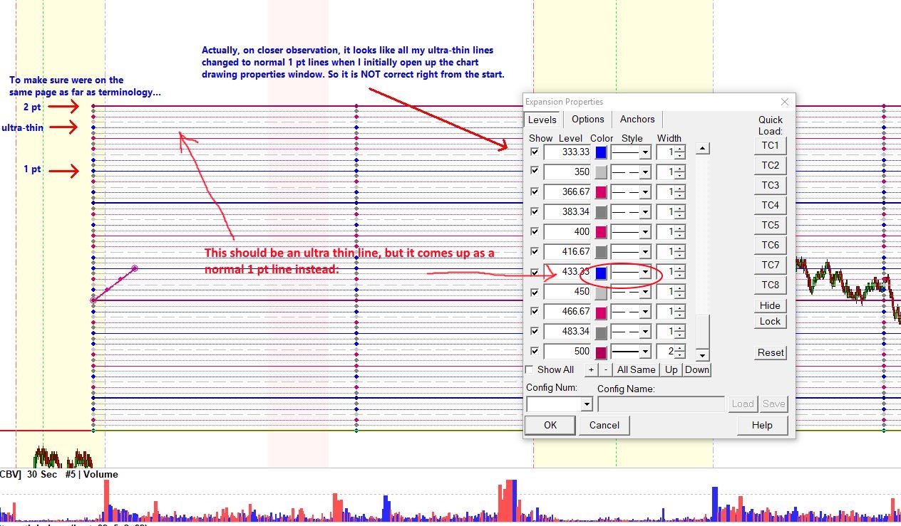

Actually, on closer observation, it looks like all my ultra-thin lines changed to normal 1 pt lines when I initially open up the chart drawing properties window. So it is NOT correct right from the start. See attached pic.
And, again, thanks for looking into this!!!

User58241 - Posts: 24
I did figure out how to get back to version 1820. Everything is back to "normal" again, so no rush for now... Thanks!

We are looking this over but could you also attach the Sierra3.CFG file following these instructions here:
This file is located in the Sierra Chart installation folder.
[2018-12-18 22:48:36]
Thank you for looking into this. I downloaded the current version (1852) and retested the chart drawing properties. The problem returned. Attached is the Sierra3.cfg file per your request. Hope this helps!
Dan
Private File
[2018-12-21 20:37:07]
Thank you for the file. We will get the problem resolved.
