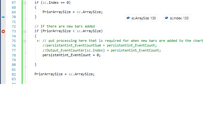

documentation implies that if sc.ArraySize grew by 1 that sc.Index would immediately also grow by one....not so.
I made a custom study that requires resetting of a persistent var on every new bar. I use a code block from your documentation to detect new bars:
"Detecting New Bars Added to Chart" from:
ACSIL Programming Concepts: Determining New Bars When Chart is Updated
what happens is that sc.ArraySize would get to 135 for instance and sc.Index would still be at 133 (should be 134)...sc.Index only updates to 134 on the second call to the study. This is a problem because sc.Subgraph[0].Data[sc.Index] = persistent_var is getting wrong value.
attached a screen shot from the debugger showing values.
thanks
Yes this is the correct behavior. This is well explained:
ACSIL Interface Members - Variables and Arrays: sc.CurrentIndex / sc.Index

if sc.ArraySize is at 135 then sc.Index should be 134...not 133 as in the attachment....take a closer look at the pic...and perhaps read the ticket.
