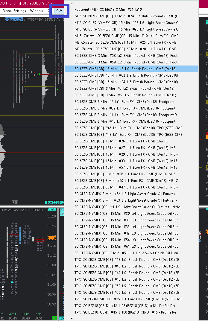

Hello
I have this folder "CW". There are many charts stored here. Whenever I open a chartbook, a chart appears on my screen from the folder "CW". I do not like that. How can I permanently delete the charts I do not need anymore?
Best regards
Jan Rabe

[2018-12-06 18:36:18]
The CW menu is not a folder, but rather is showing you what charts are currently open within the Chartbook that you have open. If there are any charts that you do not need or want to have open, then select the particular chart from the list to bring it up and make it the active window, and then select File >> Close Active Window.
Repeat this process as necessary.

[2018-12-06 19:11:14]
novaxt123 - Posts: 54
Hello
I did it. File >> Close active window. But the window does not close. What am I doing wrong?
[2018-12-06 22:16:00]
You must not be doing something correctly. There definitely should be no trouble with that command. Just try pressing the X button at the top right of the chart window instead.
Date Time Of Last Edit: 2018-12-06 22:17:02
[2018-12-07 08:41:05]
It did not work though. I've chosen narrow frames, maybe that's the reason. But I have already solved it. Chart >> Show Title Bar >> then cross top right
[2018-12-07 18:20:24]
Okay if you have hidden the title bar then this is going to be a problem but File >> Close Active Window should still work. But there could be some unpredictable behavior at the operating system level when hiding the title bars.
