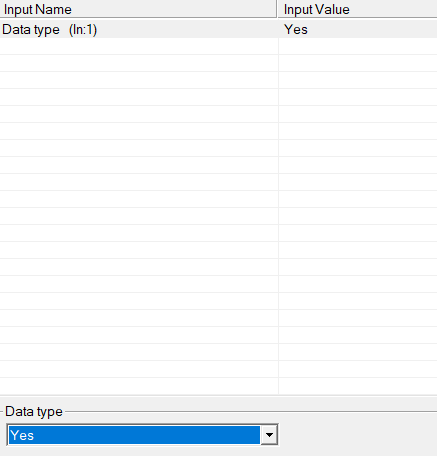

Using 1847, but also happened using 1846, CustomInputs keep resetting to YesNo input types.
SCInputRef in_type = sc.Input[0];
in_type.Name = "Data type";
in_type.SetCustomInputStrings("Type1;Type2;Type3;Type4");
in_type.SetCustomInputIndex(0);
For completeness:
- the study doesn't have any other inputs
- the data of this study bases on the data of another study
After a restart all is good and as expected, a CustomInput is with the proper values is being displayed. The problems happens randomly after opening the Studies Window and closing it, even if there is no change made to the studies.
A couple of times I also saw issues with StudySubgraphValues input types, the referenced Subgraph ID appeared corrupted, it diplayed ID followed by a very large number.

We do not believe this is a problem on the Sierra Chart side. More than likely your study is causing a memory corruption. Do you see this issue with any of the built-in Sierra Chart studies?
[2018-11-27 23:20:34]
Usermb - Posts: 126
Will keep an eye on this, the truth is this study involves some really complex stuff, memory-mapped files, dynamic allocation etc.
Could very well be something awry going on with my code. Thanks for the tip.
