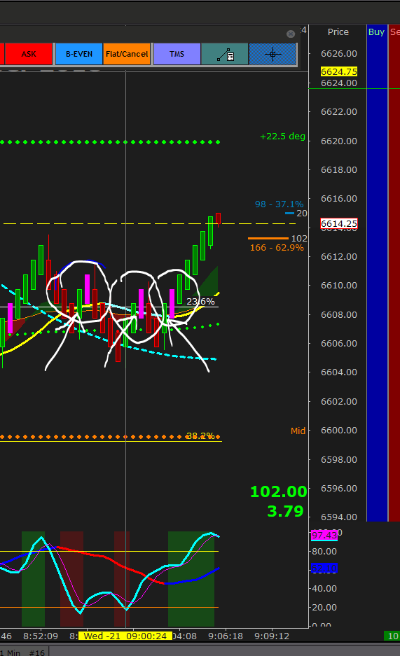

[2018-11-21 14:10:26]
Xfanman1 - Posts: 320
David, try this -->
=CROSSFROMBELOW(C[-1],ID1.SG1)
I tested this (see attached) and it works perfectly on the MA that I referenced. You can see that the bars that first crossed the Yellow/Blue MA do not signal, but the bar that follows (Fuchsia) signals as you wished.
Scott
Date Time Of Last Edit: 2018-11-21 14:13:04
imageCrossoverTestCode.PNG / V - Attached On 2018-11-21 14:10:18 UTC - Size: 46.46 KB - 500 views
