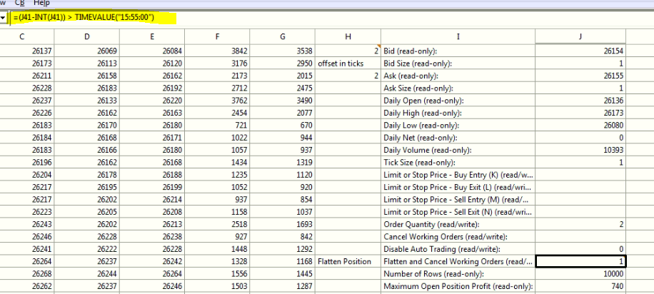

Showing a 1 in J29, on attached, using the formula suggested here:
Spreadsheet Systems, Alerts and Automated Trading: Flatten and Cancel Working Orders (read/write) [v1:J29, v2:J90]
=(J41-INT(J41)) > TIMEVALUE("15:55:00")
once the time is eclipsed, as expected.
Also have tried J89 to do similar (without formula, just the time)...
but not seeing flattening during replay, order just rolls into next hour.
What else could factor-in here?
imagej29.PNG / V - Attached On 2018-11-18 22:15:38 UTC - Size: 179.92 KB - 526 views
[2018-11-19 04:11:48]
Do you see that cell go from 0 to 1 and back to 0 as expected based upon the last bar Date-Time? We are not observing any problem with this. The formula does work as expected.

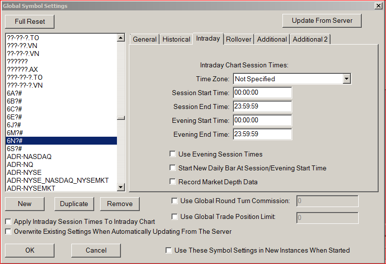

Sawtooth - Posts: 4357
According to this link...
Trade Simulation: Time In Force for Trade Simulation Mode
...when the Time In Force is set to Day, sim orders are canceled at the End Time set in the Global Symbol Settings, which is 23:59:59
See attached pic.
Why are the orders expired/canceled at 20:00 ?
image6N Global Symbol Settings.PNG / V - Attached On 2018-12-20 06:50:45 UTC - Size: 37.06 KB - 496 views
[2018-12-20 17:15:42]
We will look this over. It relates to time zone conversion.
[2018-12-25 22:35:51]
We did find a problem with this and made a correction. In the next release, according to those session times, the expiration is considered 1 second after 23:59:59 UTC time since there is no time zone specified.
