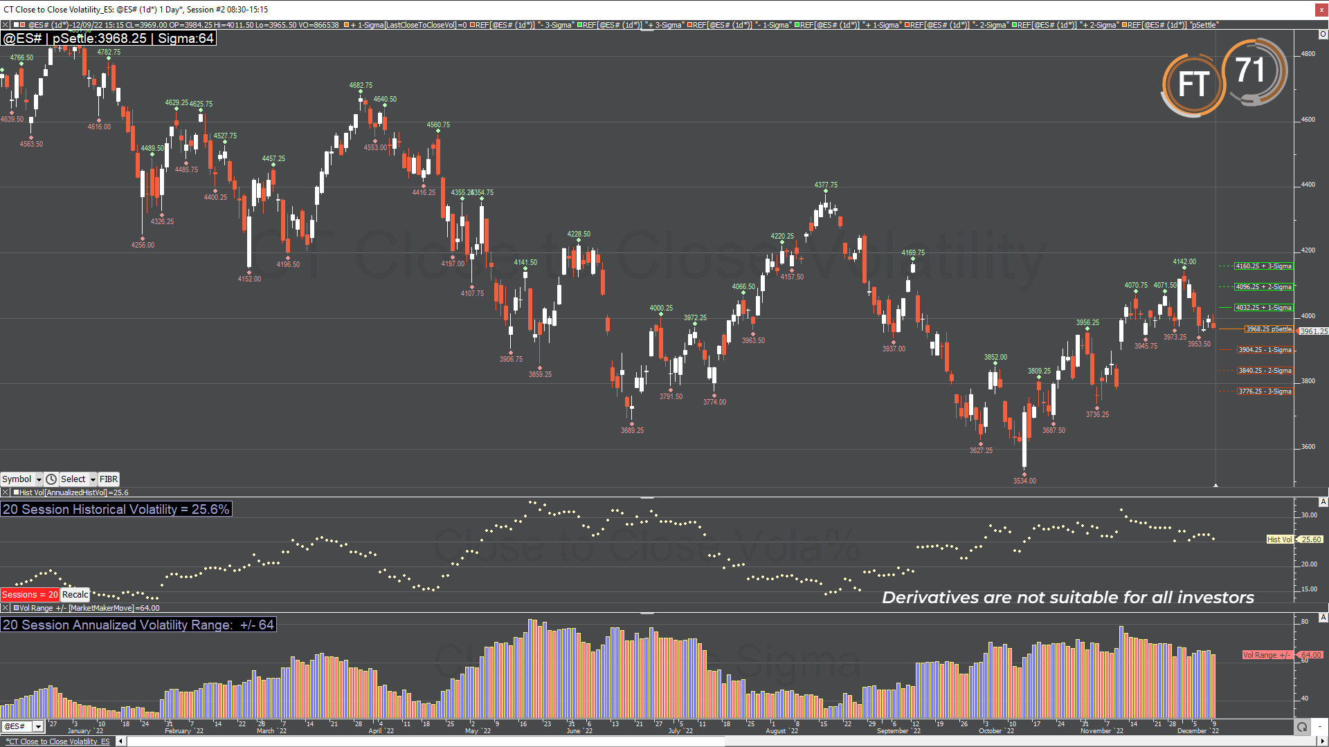

That's not what I am looking for. I am looking for a study that can calculate of for example:
The last 20 sessions, the standard deviations of range.
Is that possible to create such thing with Sierra?

[2022-12-12 09:36:04]
OriolCasas - Posts: 190
Attached you have an example on how FT71 tracks that on Investor/RT (annotations on the right of the chart (sigma +1, sigma +2...). That's what I am looking for.
This are standard deviations of range from close to close.
imageSigma Daily.png / V - Attached On 2022-12-12 09:34:18 UTC - Size: 142.32 KB - 568 views
