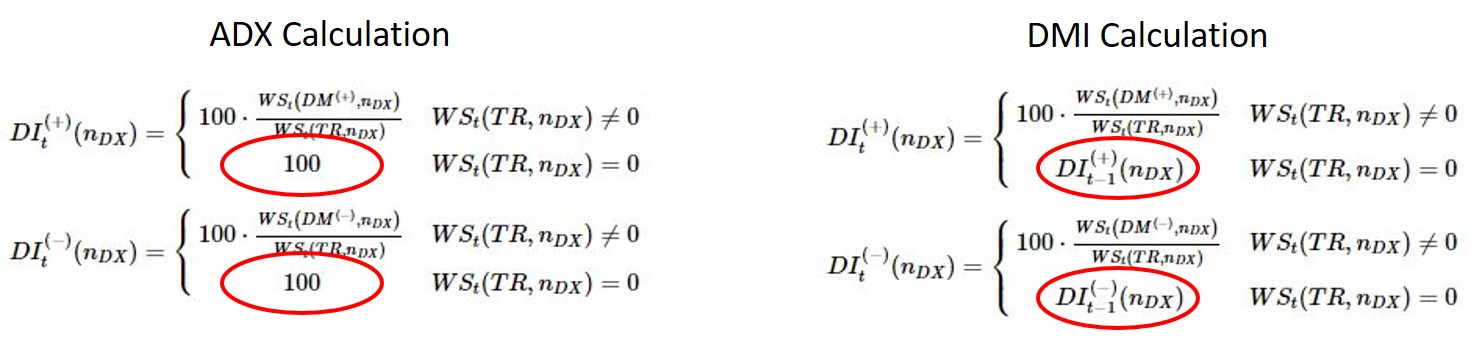

Hello, I wrote the documentation for both the ADX and Directional Movement Index (DMI) studies. I would make two comments on the response in Post #7.
First, the DMI study does not use a value of zero for the Directional Indices when the Welles Sum is zero. Rather, it uses the prior values of the Directional Indices. This should be clear with a side-by-side comparison (see the attached image).
Second, the average that is used in the ADX study is Moving Average - Welles Wilders (WWMA) - not Moving Average - Simple Skip Zeros (SZMA). It is true that WWMA defaults to SZMA when the prior value of WWMA is zero, but this almost never happens.
As to the question of whether our ADX study is faithful to the original algorithm of Wilder, I do not have an answer for that yet. I have just obtained a copy of Wilder's book New Concepts in Technical Trading Systems, where he introduced ADX. I will look into it over the weekend and give you a definitive answer on that by Monday.
imageDirectional_Indicators.jpg / V - Attached On 2018-11-30 00:06:27 UTC - Size: 88.05 KB - 721 views

SC Support Tom - Posts: 450
Hello again. I have finished my review of Wilder's discussion of the ADX, and have verified that the algorithm that he created is 100% equivalent to the algorithm used by Sierra Chart. I even used both his algorithm and our version of it to reproduce the results of Wilder's own sample worksheet on pp. 41-42 of his book. Our results matched his with zero error. I can confidently say that if the ADX calculation of any other platform disagrees with our calculation, then it is the other platform that is at odds with Wilder's algorithm.
