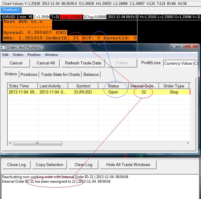

Ok, I found the problem. On Backtest or SIM trade everything is fine, but real trading (LMAX) modify order, not modified, but cancelled and remaked order therefore I lose order ID.
I attached screenshot.

In the case of LMAX, the Internal Order ID does change when modifying a Stop order because LMAX does not support modification of stop orders. We first have to cancel the order and issue a new order.
It is not possible after a modifying a Stop order through LMAX to immediately get the new internal order ID like this:
int result = sc.ModifyOrder(NewOrder);
if (result>0) OrderID = NewOrder.InternalOrderID;
So therefore, after the order modification is complete you would need to iterate through the orders using this function:
http://www.sierrachart.com/index.php?l=doc/doc_ACSILTrading.html#GetOrderByIndex
to find the particular stop order you are looking for.

The proper solution is that we need to make sure the Internal Order ID does not change. We should be able to accomplish that. Please give us about a week. And check back with us.
When you submit orders, the Internal Order IDs are set and you can get them. When they do not change, you can always rely on them. And then you can get the order data using a specific order ID.

We have finally completed this. The internal order ID does not change when modifying an order with LMAX. Normally this is the case with most services but there was a special case that had to be handled with LMAX.
This change will be out later today in version 1051.
