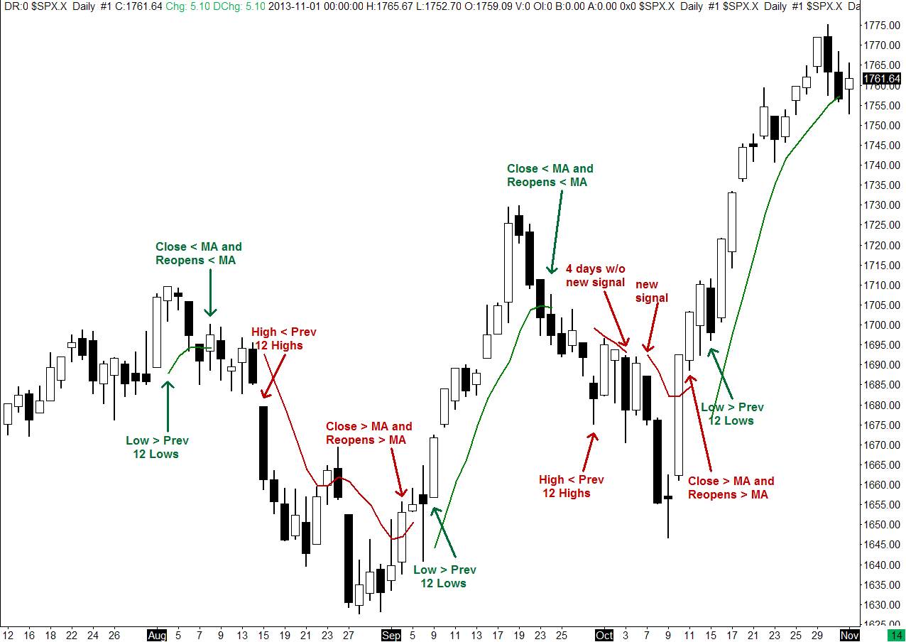

Thanks for your input. Aspects of that are correct, I was able to get something similar, although it needs some minor tweaks in terms of the conditions.
- "Lower Moving Average" is bullish (green) and based on 5 SMA of the lows
- "Upper Moving AVerage" is bearish (red) and based on 5 SMA of the highs
- Both MA's extend 4 price bars ahead
- There would only ever be one MA appearing at one time. For example. A low is higher than all 12 prior lows -> Bullish lower green TD MA appears based on the 5 SMA of the highs -> the bullish lower MA continues as long as price doesn't close below the MA and then reopen below it also, OR as long as price records a low above all 12 prior lows within the next 4 bars
I've attached an image of the SPX daily with the MA's Drawn on as they should appear (note you can't see it extending 4 bars ahead due to the image too short.
Appreciate any input, many thanks.

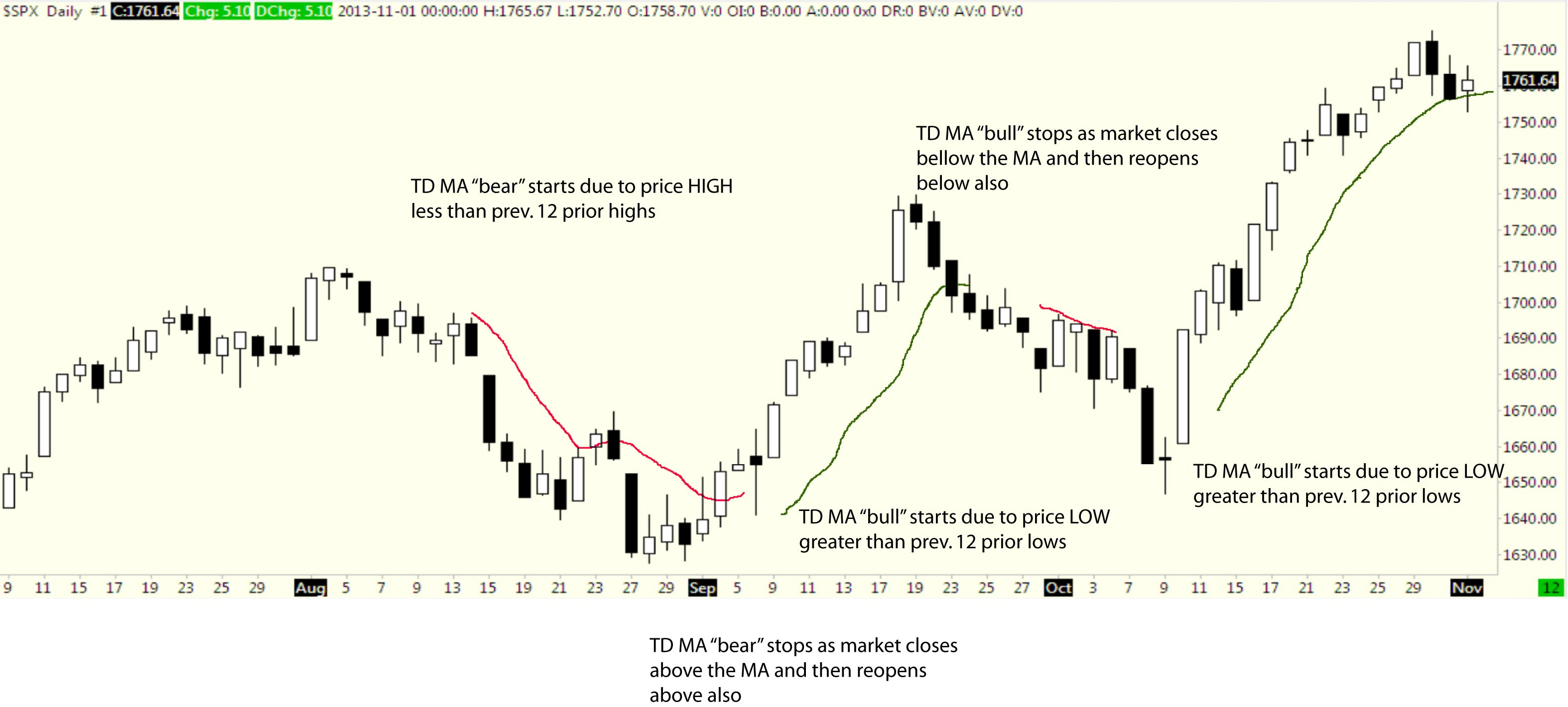

jackw - Posts: 57
I think I got it this time. Of course I said that last time, and I wasn't even close. Take another look.
Attached are the source and dll files along with a marked up chart of the SPX with the indicator on it.
Date Time Of Last Edit: 2013-11-03 19:20:35
