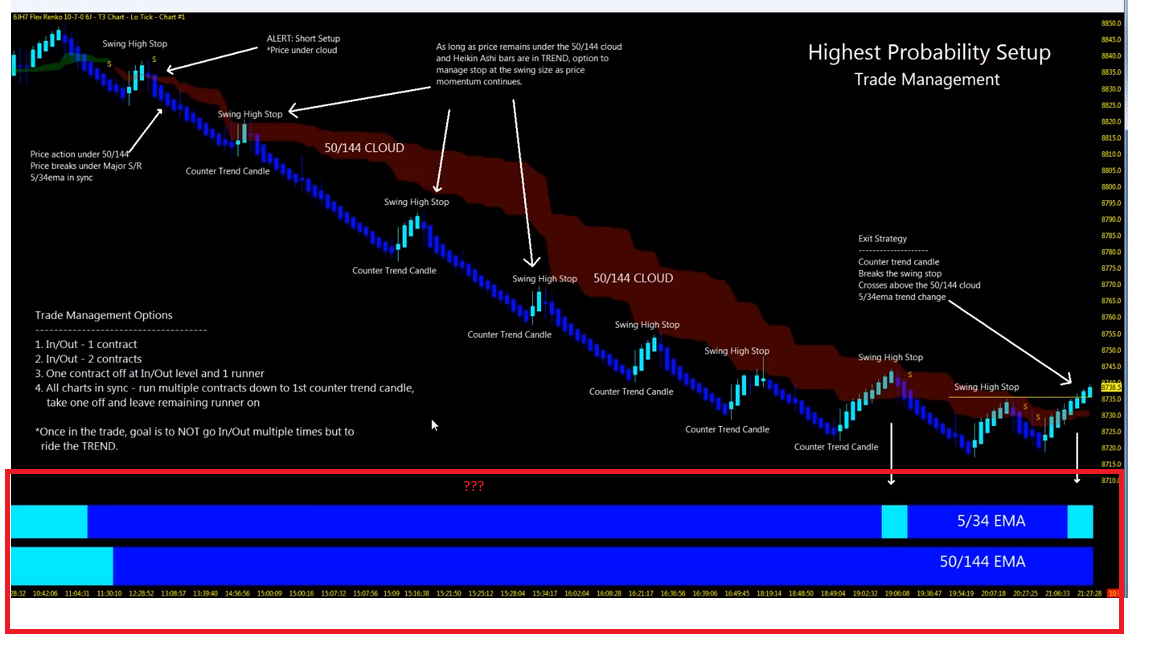

what kind of study was used to generate the ema bars at the bottom of the attached chart (red rectangle)?
thanks
imageUntitled.png / V - Attached On 2018-11-06 00:47:16 UTC - Size: 317.96 KB - 1502 views
The color background based on alert study is used to indicate when one moving average is above/below another. The cloud is the overlay of two moving averages from another time frame.
This is the T3 system available here: https://forgivingcomputers.com/t3strategy-summary/
[2018-11-06 15:45:32]
ForgivingComputers.com - Posts: 1251
Create an alert condition that is true when one MA (ID1) is greater than another MA (ID2):
id1.sg1>id2.sg1
Color the background green. Put the study in Chart Region 2.
Duplicate it, change the color to red, and the > to <:
id1.sg1<id2.sg1

To get the cloud referenced in Post #1, open a 1-minute chart and add the study entitled Moving Averages with a 50-SMA and 144-SMA and ignore Moving Average 3. Use Fill Top and Fill Bottom.
Transfer that cloud to your Heiken Ashi Renko chart as taught by David Katz.
