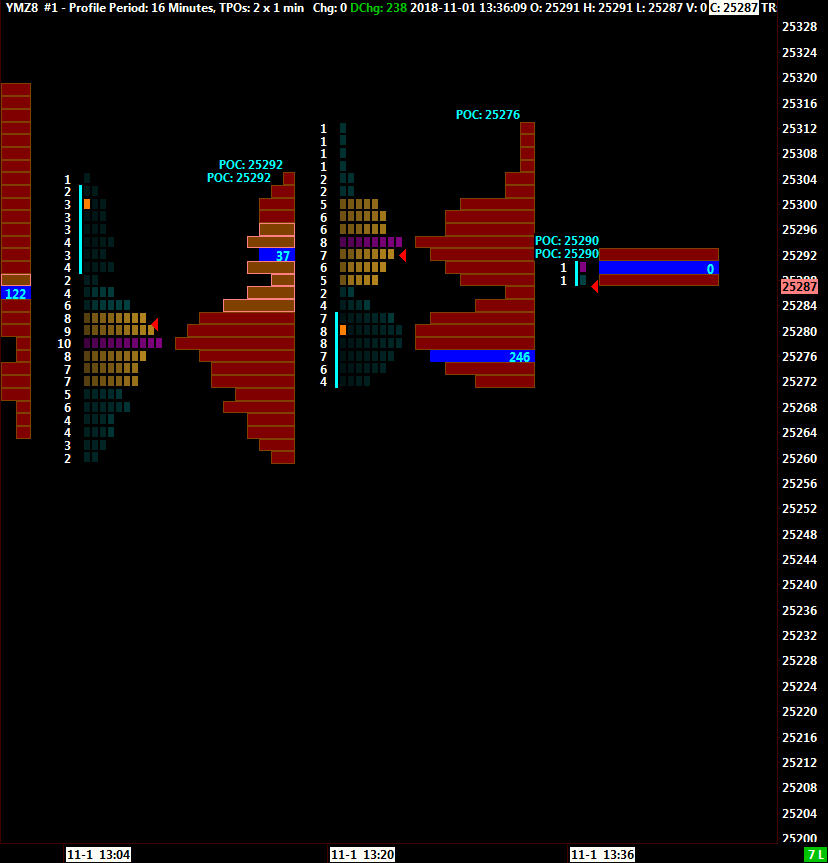

When I use the VBP study on a chart that is filtering volume and turn on the show POC value option it prints it twice instead of once. I want the information but visually it's a real pain. Is it something I'm doing on my end or something that you will need to address?
http://www.sierrachart.com/image.php?Image=1541093771945.png

It should not be showing twice. But we are not able to reproduce the problem. Can you please attach your Chartbook with that chart in it per these instructions:

Okay, I removed all irrelevant studies. Again, I stress it only occurs when I use Volume Filter Exclude <=. When that is not used it prints normally.

John - SC Support - Posts: 48526
We know why this is occurring and we are working on a fix.

The behavior does relate to using volume filtering and we will implement a solution.
