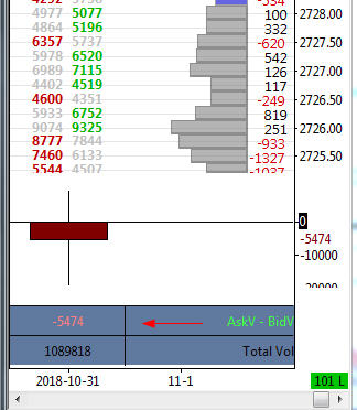

[2018-10-31 18:29:51]
User731023 - Posts: 167
Look forward to the Bid/Ask work.
What a joke....
I have -5474 delta and everyone else is positive 4000.
The volume was as bad. Will see if it is better later.

[2019-02-28 18:26:11]
This is not going to get resolved until Transact releases their new non-bridge websocket API.
