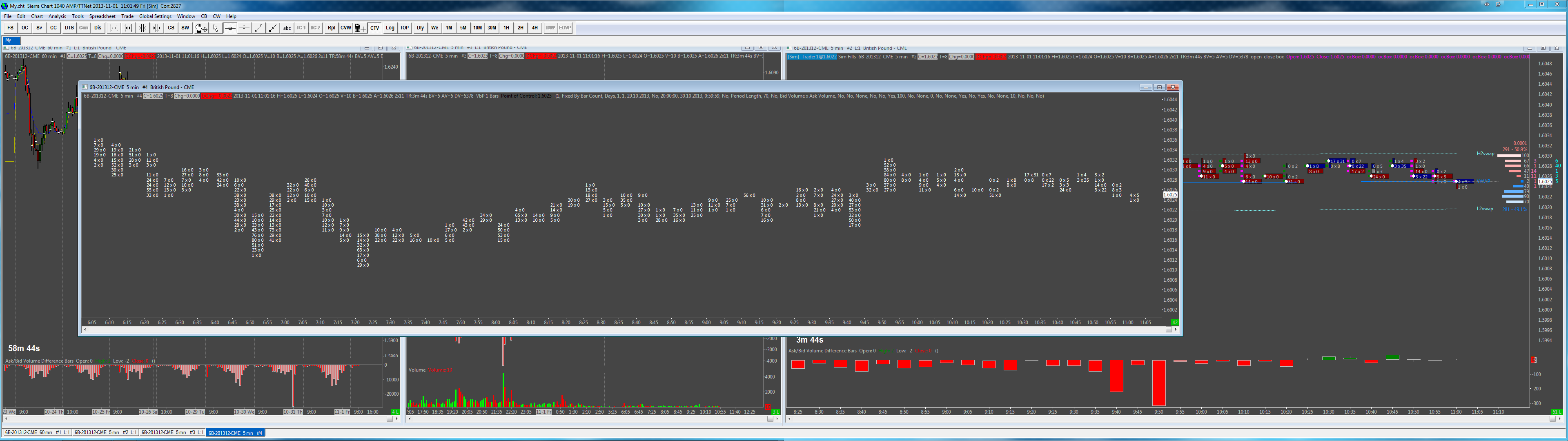

I've experienced an issue with the part of the historical intraday data /bidxask/.
Please see the attachment.
Thank you.
image1032781.png / V - Attached On 2013-10-31 14:43:26 UTC - Size: 86.08 KB - 718 views
[2013-10-31 16:41:28]
So are you referring to the zeros for the ask volume for the bars before the last two bars?
If so, re-download the data by selecting Edit >> Delete All Data and Download.

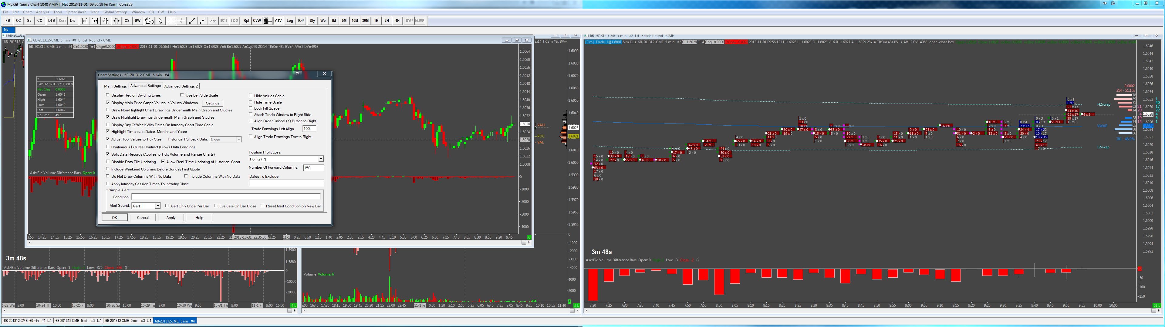

User025930 - Posts: 8
I did not get to add a picture on your instruction ...made through printsсreen
Date Time Of Last Edit: 2013-11-01 04:07:40
Private File
image2.png / V - Attached On 2013-11-01 04:07:33 UTC - Size: 391.46 KB - 664 views

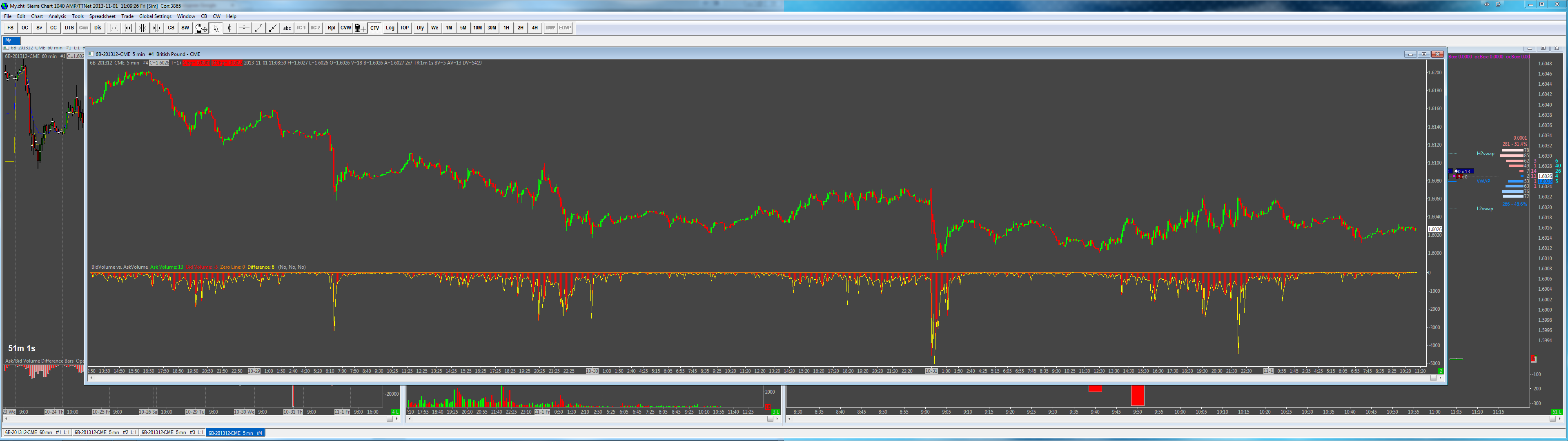

Date Time Of Last Edit: 2013-11-01 05:05:50
image1.png / V - Attached On 2013-11-01 05:05:46 UTC - Size: 391.02 KB - 723 views

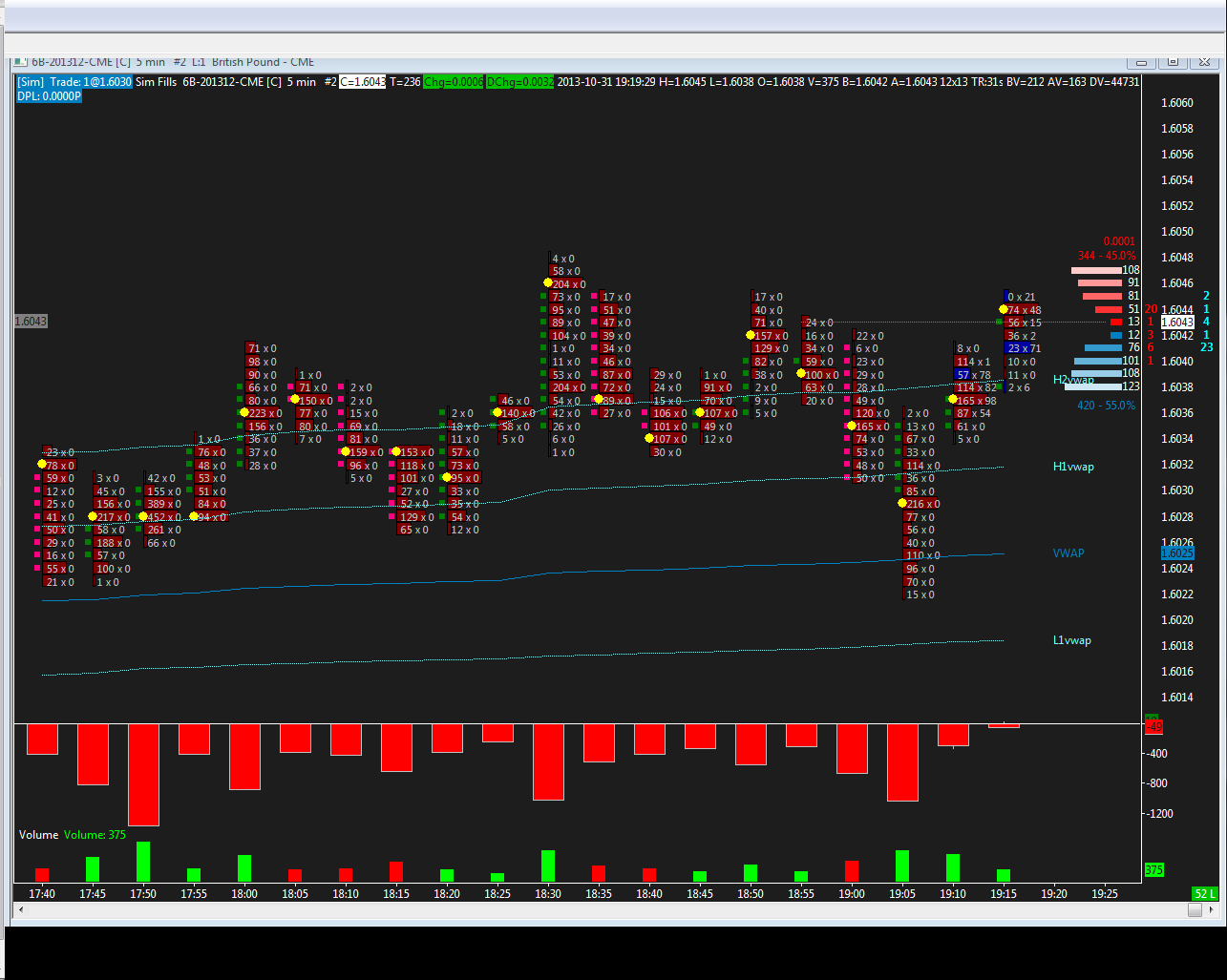

another image.
image2.png / V - Attached On 2013-11-01 05:12:23 UTC - Size: 367.52 KB - 652 views
[2013-11-01 05:17:53]
OK we found the problem. We were not checking the data after it was downloaded but only at the source . This is why what you were showing was puzzling because we knew it was OK there. This is now resolved. Go to the chart and re-download the data with Edit >>Delete All Data and Download.
