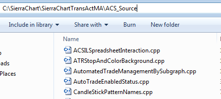

User701453 - Posts: 176
Yes the file does exist in the folder.
Attached screen shot of directory path.
imageFile exist.png / V - Attached On 2020-01-22 01:34:21 UTC - Size: 9 KB - 390 views
