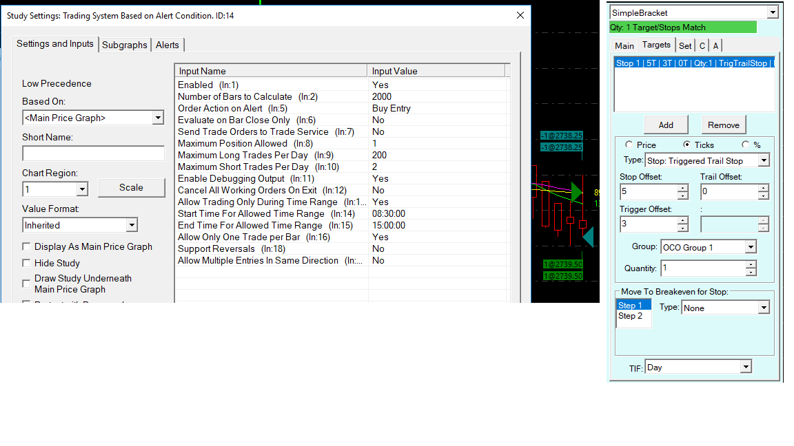

"Trading System Based on Alert Condition" study has a the following MAJOR bug:
setting the "allow only one trade per bar" setting to "yes" does not work.....system still places several trades on the same bar....attached
trade window Q set to 1 as is the .
thanks
imageUntitled.png / V - Attached On 2018-10-25 10:23:11 UTC - Size: 57.65 KB - 533 views

There definitively is no bug here. Your conclusion is incorrect. Read each and every paragraph in this section here:
Automated Trading From an Advanced Custom Study: sc.AllowOnlyOneTradePerBar (sc.AllowOnlyOneTradePerBar)
And take the time to understand what is written.

User525733 - Posts: 126
thanks.
I did.....I had ONE "Trading System Based on Alert Condition" study...it is a BuyEntry.....nothing else.
the system entered the first position and was stopped out, then entered a position again and was stopped out the second time.
I only highlight the issue so you are aware and can polish this nice product.
[2018-10-29 18:21:14]
We have looked into this and we cannot see how more than one trade of the same type can be initiated on the same bar and as the documentation explains, the placement of the fills is not conclusive.
We also have insufficient information to even comment on this because we do not see the Trade Activity Log and we also do not know what type of chart bars those are.
This is the message you see when in the Trade Service Log when an additional trade of the same type is initiated:
Chart: Replay 2.00X: YMZ18 20 Min #1 | Study: Trading System Based on Alert Condition | Order entry skipped because only one trade per bar is allowed | 2018-10-29 14:20:17
Date Time Of Last Edit: 2018-10-29 18:21:29
