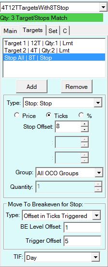

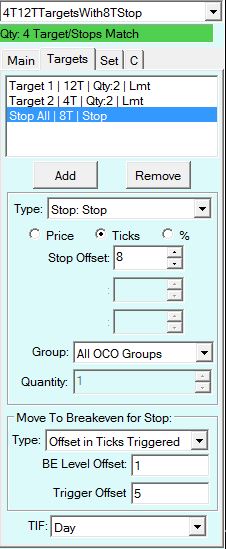

I am attempting to setup Attached Orders through the Trade Window. Currently, the issue remains with the following attached orders setup (screenshots provided - should be in order of reference):
Working correctly - Two targets w/ common stop. The targets are in separate OCO groups (1&2) and the Stop is set to ALL OCO Groups. This configuration is saved using a total of 2 contracts and works fine. Stop Quantity = 2, Target 1 Quantity = 1 and Target 2 Quantity = 1. See attached screenshot. This saved configuration even works when I change the Total Quantity to three (3) - see attached screenshot.
NOT Working as I Need it To - When I change the Total Quantity of contracts (ES) to something other than 2 or 3, the target totals are not what I want (remember, I want my runner quantity to stay at 1, no matter the number of contracts traded - unless I manually change it once in a trade). See last two screenshots.

The solution to a problem like this is that you need to save a different Trade Window configuration for each parent order quantity and Attached Order configuration that you want.
The way that Sierra Chart is going to distribute the parent order quantity across Attached Orders may not be as you want, when changing the quantity.
Here is the documentation for saving and switching between Trade Window configurations:
https://www.sierrachart.com/index.php?l=doc/doc_TradeWindow.html#TradeWindowConfigurations
