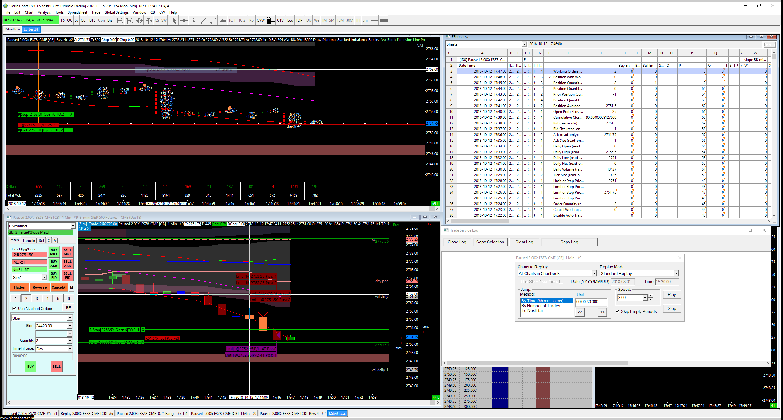

Thanks for the last "post" but doesn't work. I don't understand. For explain, I 'v post Screenshot below. My setup is an orange vertical line on Footprint. At 18:36 an Order SELL entry was sent, it's correct, but at 18:37 an other order was sent, that's not correct !
Signal Only On Bar Close (Columns K,M) / (Columns L,N-Z) Input to Yes, OK.
Where is the bug ?
bests
SR

[2018-10-15 18:41:28]
While this is not related to the problem we see you are running an older version. We want you to update following the instructions here:
From Documentation:
In summary, the standard Up and Down arrows on a chart displayed by these Spreadsheet studies and the result of formulas in cells K3, L3, M3, N3 (or at row 4), indicate the present state of the formulas. During the formation of a bar or after new bars are added to the chart, a formula could go from TRUE (1) to FALSE (0) based upon the logic of the formula and changing data in the cells that it references. It is up to you to determine specifically what is happening and why.
To actually see where the trades were made, you need to display Order Fills on the chart. You can also refer to the Trade Activity Log.
It might help to use Strict Evaluate on Bar Close:
Spreadsheet Systems, Alerts and Automated Trading: Strict Signal Only On Bar Close Evaluation
Date Time Of Last Edit: 2018-10-15 18:44:27

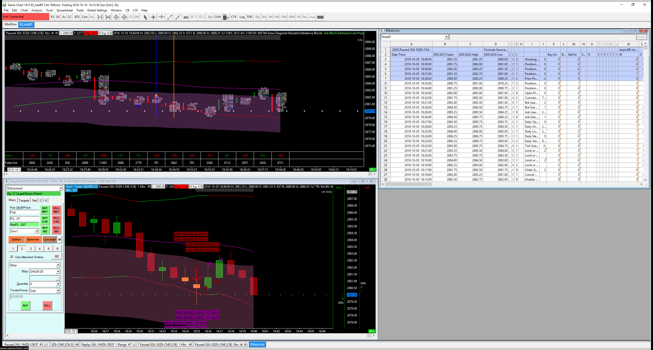

stephane1 - Posts: 112
HI
Sorry but doesn't work.....after set yes "strict signal.....
http://www.sierrachart.com/image.php?Image=1539638404525.png
bests
SR
[2018-10-16 20:27:31]
We can only refer you to this documentation here:
Automated Trading Management: Troubleshooting Automated Trading System Behavior
