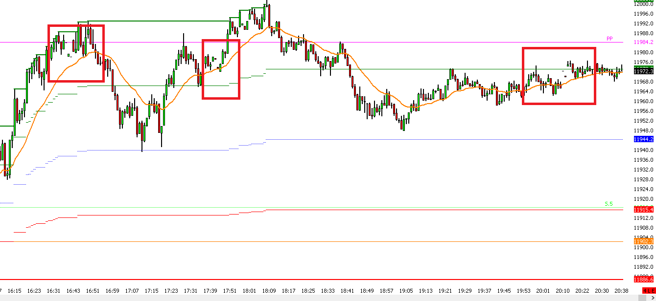

Today LMAX data froze at least 3 times on GDAXI, it was completely stuck.
Here is a 1 min chart on GDAXI, after a history reload
Time is GMT+2.
Can you check the server ?

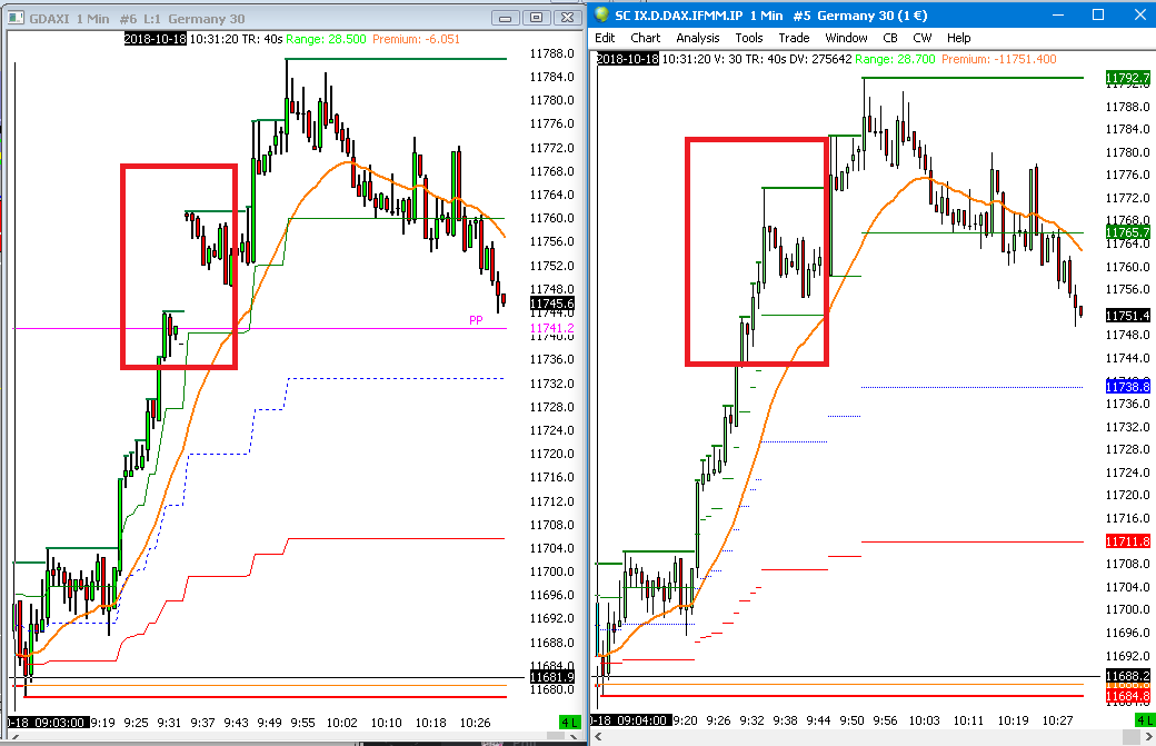

no I did not lose connection because
1. I don't have auto reconnect on so I would have needed to reconnect
2. I don't have any disconnects in the log.
And there are definitly missing data (see LMAX vs IG, and I did a redownload data).
Time is Paris time GMT+2
imagelmaxgap.png / V - Attached On 2018-10-18 08:49:26 UTC - Size: 48.93 KB - 420 views
[2018-10-18 09:17:30]
For reference we always look at the symbol EURUSD and there was no missing data there. It is quite clear this was an LMAX interruption. So the issue was on the LMAX side. This is quite clear.
