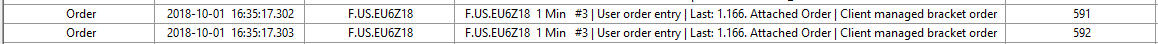

While I indeed only got charged USD 0.10 on my next trades, I noticed that in Sierra's trade activity log, suddenly the former description of exactly the same type of order had changed from "...Attached Order / Server side OCO order" to "...Attached Order / Client managed bracket order". (see attachments)
While technically this is corrrect, as the bracket orders are client side, the associated OCOs should still be server side, as indicated before.
I contacted my broker on this one and asked for clarification if CQG or Dorman maybe not only reduced my transaction fee but also do not provide the server-side OCO functionality anymore due to the lower cost.
According to my broker's response, both CQG and Dorman claimed that nothing had been changed in that regard from their side and that I should contact Sierra Chart about it (which I hereby do).
So, can you please let me know why the described change in the description has changed the moment they reduced my transaction fee? Did anything change on Sierra's side?

Answering my question No. 3 you write that this is most likely coincidental and that I might have updated Sierra Chart.
Yes, I update it on each weekend (if there is a new version); now I'm on version 1815 (64 bit) and that was the 2nd update since my trade where "Server Side OCO order" still appeared. I did not see any notification about a version 1819 (or is there different update numbering for 32 and 64 bit versions)? (Note that I do not download "PreReleases".)
But if it was caused by the update, actually YOU should be able to tell me if in the current version the type of messaging in the trade activity log was changed by Sierra chart or not, right?
Moreover, on the page you sent me the link of, the following is written:
How do you know whether your Trading service supports OCO functionality? ... You will know if your Trading service supports OCO functionality when you submit an order. In the Trade Activity Log, in the Order Action Source field for the order, server-side managed OCO orders will contain the text Server side OCO order.
As I explained in my first message, that "Server Side OCO Order" indication had disappeared and was replaced by "Client Managed Bracket Order".
So, does that now mean that my OCOs are NOT handled server side, in spite of the clear indication on your Data and Trading Services page for CQG that Server-Side OCOs ARE supported in both, FIX and Web API?
Or has the text on the page not been updated after Sierra Chart had changed the description in the trade activity log in one of the last updates?
As far as I understand the entire page, currently I tend to believe that my OCOs are NOT handled server-side once the parent order got filled, as it is not indicated in the trade activity log. The question is WHY?
(I am using Web API, which should support it, and I have "Use Server Side OCO Orders" ticked under "General Trade Settings", too.)
Unfortunately, I don't understand your following sentence:
We also need to look at the logging indicating whether OCO and bracket orders are managed on the client-side or server-side. We can see how when a bracket is client managed, there still can be server-side OCO and that needs to be indicated.
I sent you the logging as attachments. Or are you talking about some other logging? If so, which? Please let me know, and I can send it to you.
Or did you mean that you will look at my logging from your side and come back to me on that one?
Thank you very much in advance for your feedback.
[2018-10-09 20:49:03]
Update to version 1819 and the trade activity logging does now indicate that server-side OCO is being used for the attached orders if they actually are. This was not previously being logged but still server-side OCO was being used, if they are supported on the server side and you did enable that option.
[2018-10-10 10:16:39]
User882915 - Posts: 32
Thank you!
Now it is indicating "Attached Order / Client side bracket order / Server side OCO order".
So, all good now.
