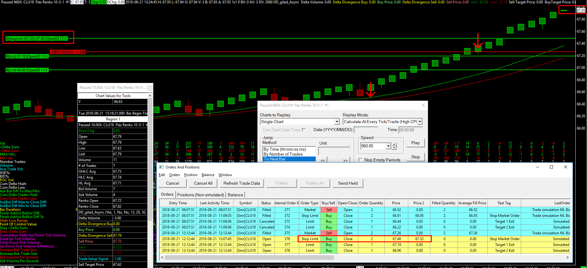

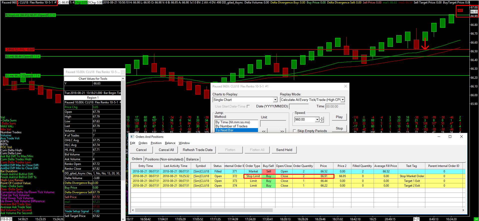

1. "price above stop" you can see my short position and although price is higher than stop price it's not being triggered.
I think it has to do with the renko chart setup as the position does get "stoped" later on after price went down from 60.95 to match the stpo price @ 60.91.
how can it be that the order is not being triggered base on price?

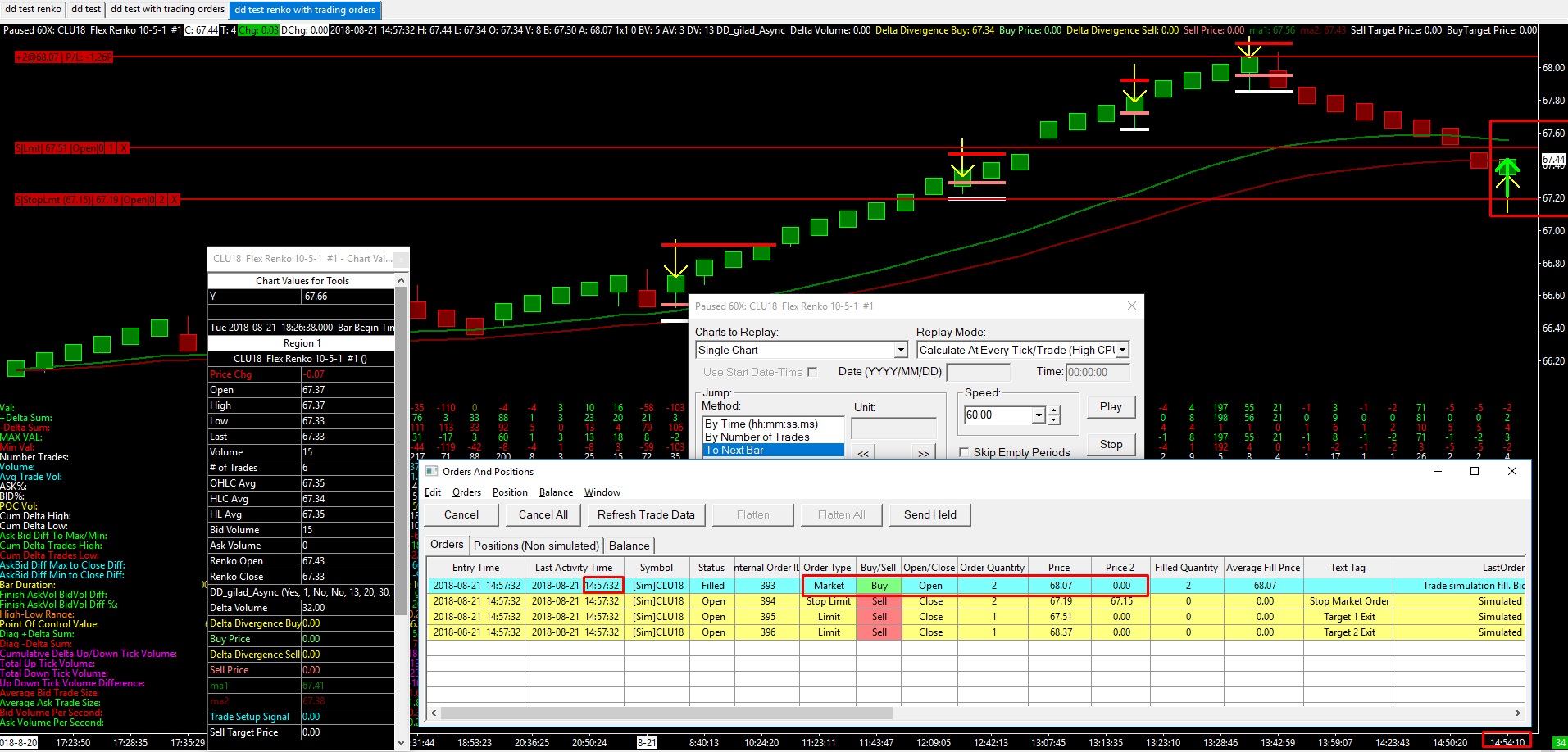

2. the same thing happens on 2nd short trade
3. when entering later a long trade, the entry price (68.07) has nothing to do with the actual price at the time/bar of the entry marked (~67.44)
this didn't happen before. can it be kind of cash memory issue? the setting of the renko?

Also you are using Stop-Limit orders.
This may have been the bid or ask price at the time.

yes this is reproduced on manual trading
i checked time& sale and the bid /ask is 67.3 X 68.05
this is over CLU18 on Aug. 21st around 14:57 est time.
it's my mistake as it was last day of trading for this instrument and i didn't notice that in first place
