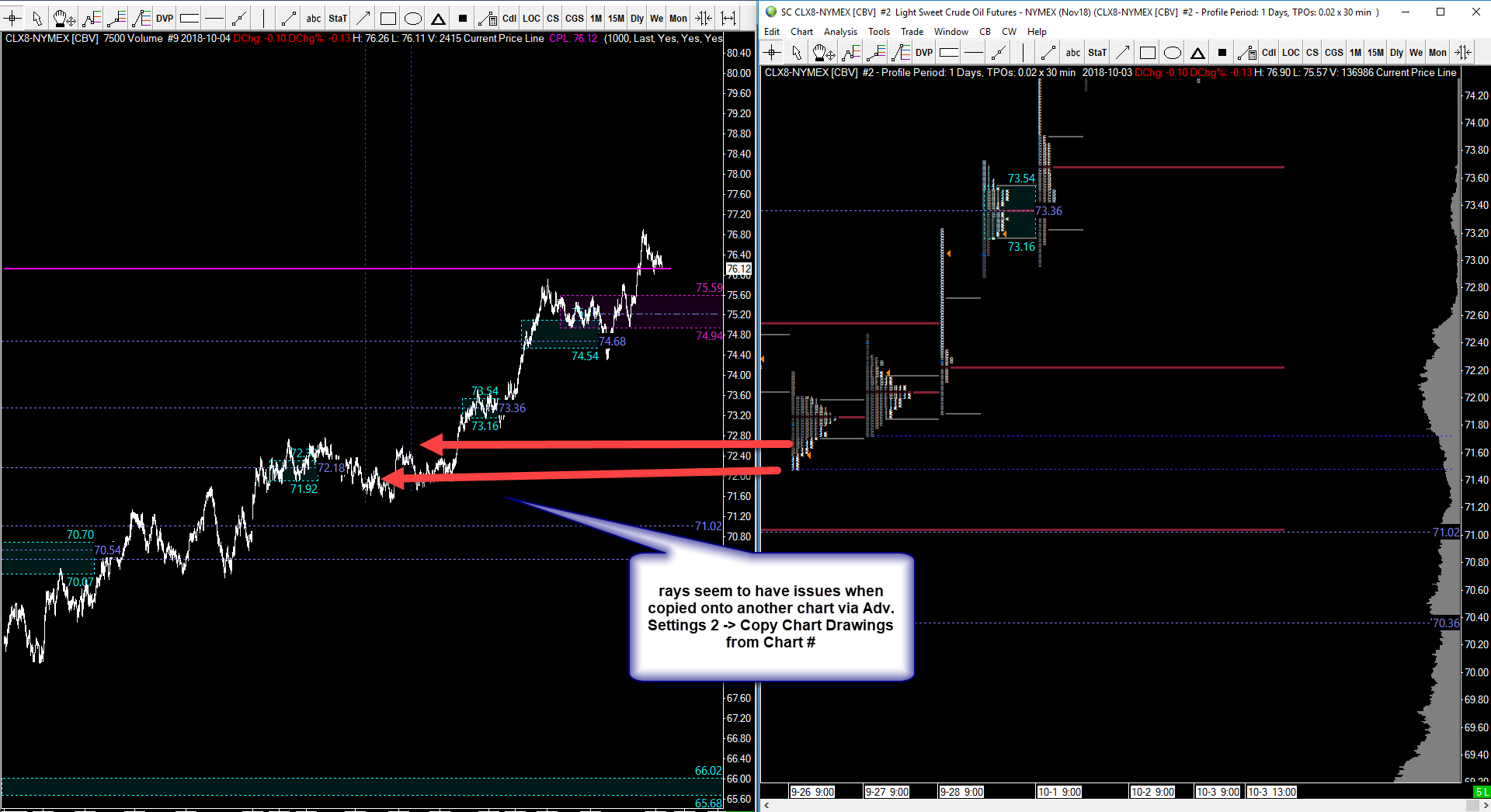

Cavalry3162 - Posts: 523
Hello SC,
obviously there is an issue with rays when yo try to copy them onto another chart.. see screenshot where the blue lines are rays from the right chart but copied in a 90° angle...(?)
please advise.
thanks,
Andreas
image2018-10-04_08-04-17.png / V - Attached On 2018-10-05 12:55:33 UTC - Size: 148.69 KB - 417 views

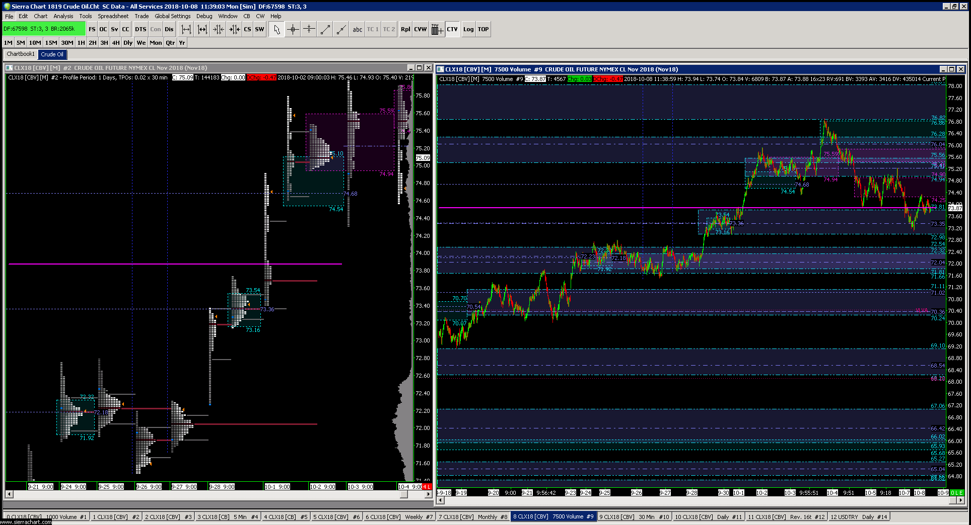

John,
thank you for your follow up..
the thing is though, they arent vertical in my chart #2.. see screenshot:
best,
Andreas
Date Time Of Last Edit: 2018-10-08 16:52:30
Private File
