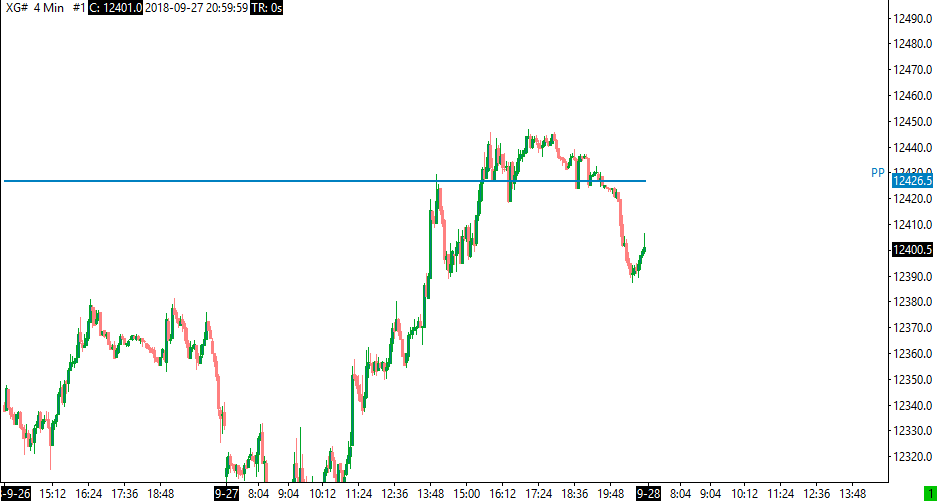

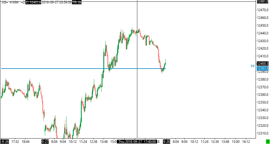

I loaded variable pivot points with identical settings on 2 separate charts. I noticed that the pivot points were at different levels on the 2 charts.
I have since worked out that in chart settings, If i load 40 days in one chart, but 45 days in the other chart, this causes the pivot points to be at different levels.
I have not altered any default settings in pivot points.
Please Advise

[2018-09-27 20:32:43]
User41512 - Posts: 58
http://www.sierrachart.com/image.php?Image=1538080089789.png
http://www.sierrachart.com/image.php?Image=1538080122523.png
Identical charts, with identical studies, only diffrence being that one chart has 40 number of days to load (in chart settings) , and one has 50.
But the variable pivot points are at 2 different levels.
Rgds
