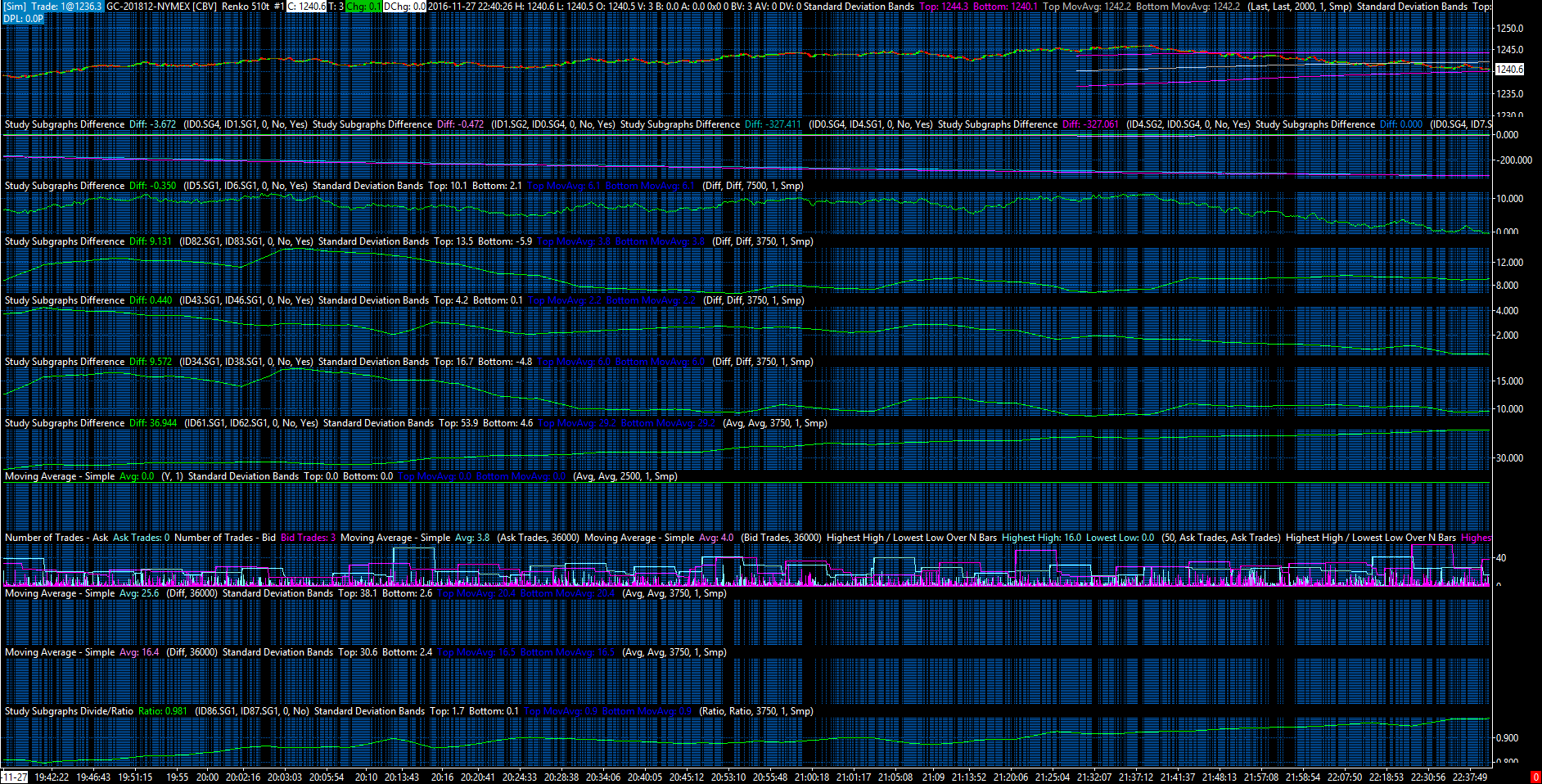

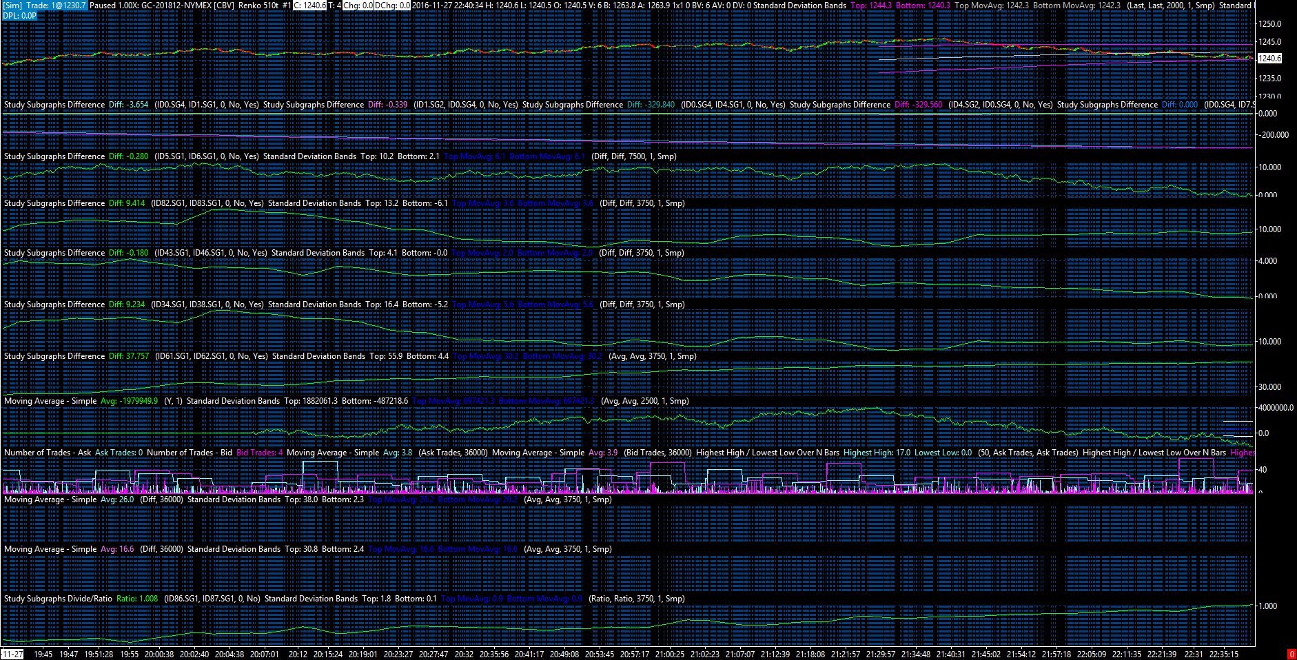

[2018-10-02 01:25:59]
doctor10 - Posts: 88
Here are some shots. Fist two screens below show values for the studies that are within the typical variance in values I am used to seeing between any two data sets and versions of sierra chart.
http://www.sierrachart.com/image.php?Image=1538437446418.png
http://www.sierrachart.com/image.php?Image=1538437511902.png

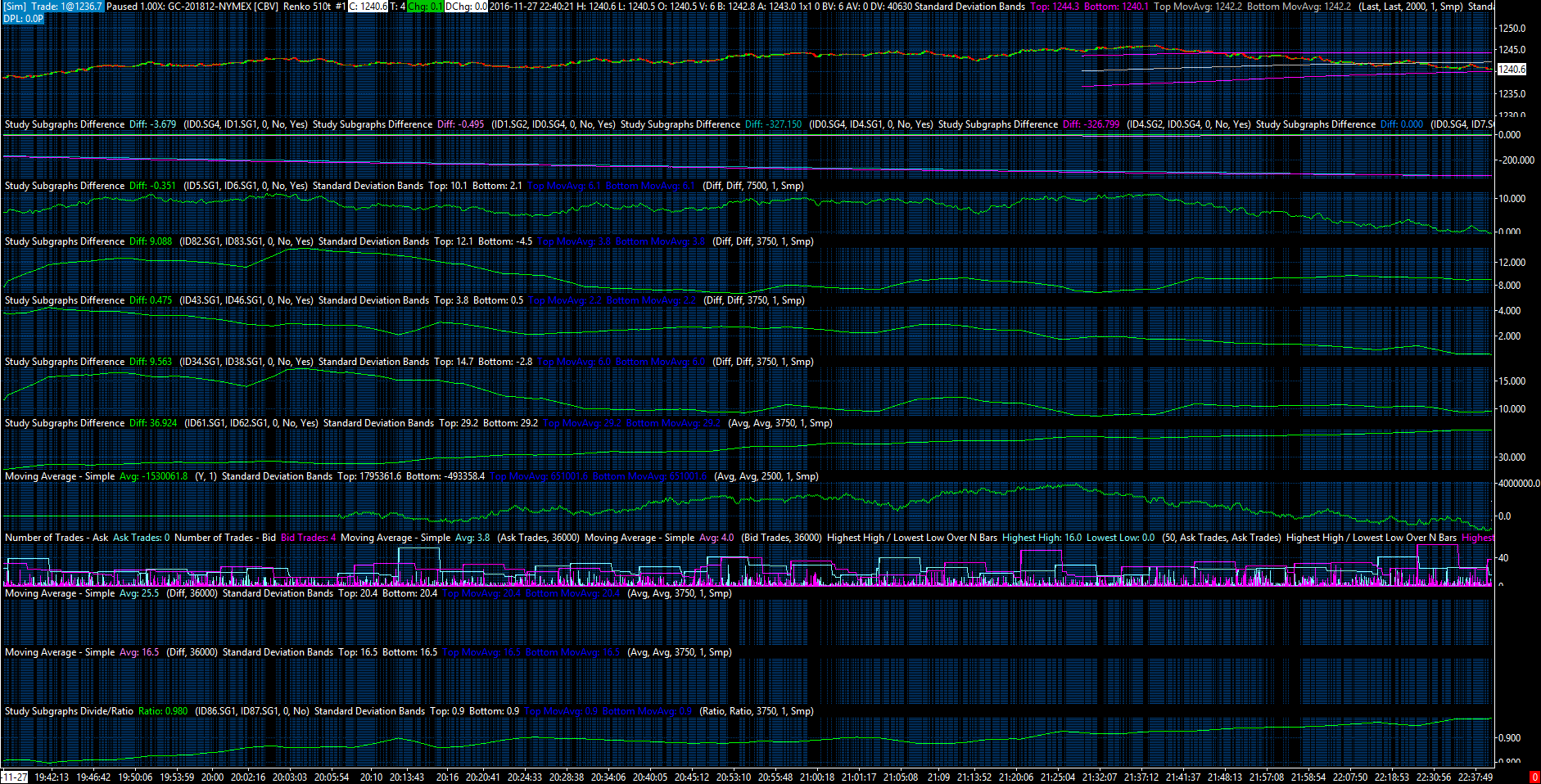

The third screen below shows how post 1793 sierra calculates the same studies. The darker blue grid indicates that it is the same instance of sierra chart that I used to take the version 1781 screen in link number two. The data remained completely unedited between the two shots.
http://www.sierrachart.com/image.php?Image=1538442966172.png
I know you guys are busy but I don't want to be stuck on old versions...
I am aware of my unorthodox renko settings. I would like to be clear that I have been using this format for quite sometime in real time and back test without issue.
Please let me know if I am SOL...
Date Time Of Last Edit: 2018-10-02 11:36:43
