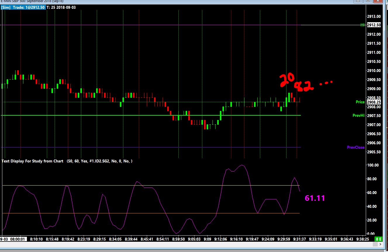

I am on a quest, to discover a study (or combination of studies) without using spreadsheet, or C++, which places the value of a study (subgraph) above/below the candle which the study was triggered.
In the example shown in the attached file, I have StochRSI (slow) peaks (green) and nulls (red) superimposed on the main chart.
I wish to replace these vertical lines with the actual value of the study, either atop or below the candle.
Mark
imageCapture.JPG / V - Attached On 2018-09-03 13:32:59 UTC - Size: 147.82 KB - 449 views

Sawtooth - Posts: 4361
Try this:
Use the Color Bar Based On Alert Condition study, with the formula used to draw the current vertical lines,
set the 'Based On' to the Stochastic RSI study,
set the 'Output When Condition True' to 'Use Input Data',
set the 'Input Data' to Stochastic RSI,
on the Subgraphs tab, set the Draw Style to Value On High, or Value On Low.

User7817001 - Posts: 96
Perfecto!
Thank you
