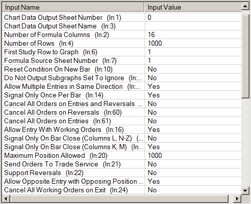

1) For close-of-bar entries, formulas in column J should reference row 4:
J22: =C4+1
J24: =D4-1
('Signal Only On Bar Close' only affects Formula Columns).
2) Try the spreadsheet study settings in the attached pic.
imageSS settings for simultaneous buy & sell.PNG / V - Attached On 2018-09-02 00:54:56 UTC - Size: 26.97 KB - 591 views
[2018-09-02 01:34:00]
User476002 - Posts: 28
Thanks for the suggestions Tom!
I tried referencing c4 and d4, and used the settings from your image. But still getting the same result: it is executing the buy and then within a tick and less than a second later, executes the sell. And it isn't using the limit price.
